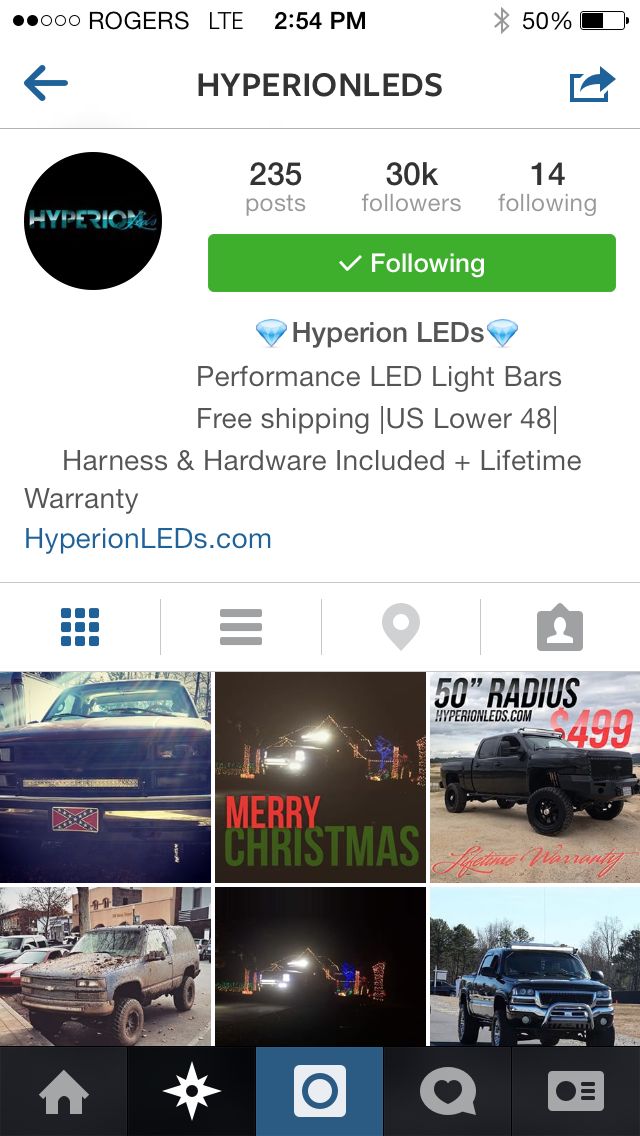

Anything on Hyperion both of those guys were good and fast to deal with

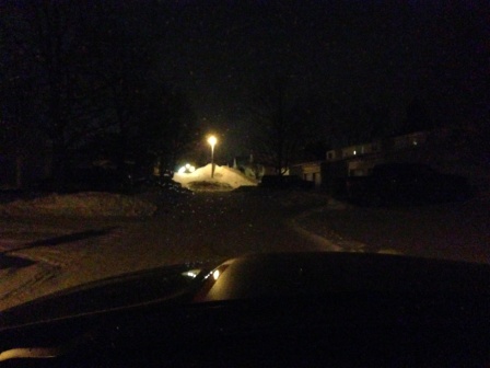

So my ARB's are hooked up. This first picture is the low beam, HID's factory on the 2015

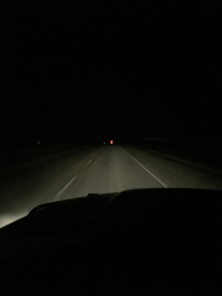

High beams.

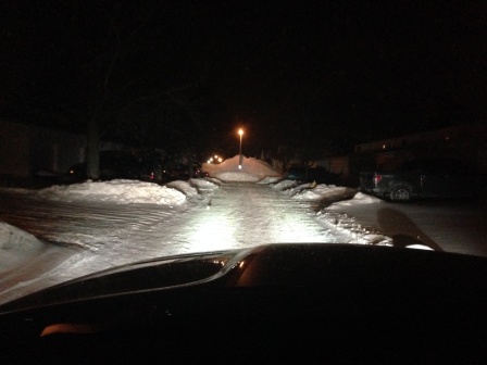

And the ARB's. One spot, one flood. I am very impressed with them.

Looks like they're aimed too low, or is it just my imagination? Definitely bright, though!

Re: Off and On Road Lights
The spot is aimed properly, the flood is another story. The patch isn't so bad in real life, but I've actually tipped it back to lessen the blinding spot on the ground. If I had it to do over, I'd probably go with two spots. I may be buying another pair for the jeep, if I do, it'll be two spots, and then move the flood to the jeep, and run the spots on the truck.
I call that "light backwash". Almost too much light.
Never thought i would live to see the day when TV's were too big & too clear & aux vehicle lighting was too bright !!! LOL
That light would be perfect without the bright spot there. Looks very evenly spread otherwise.
I'll take a pic of the angle I had to tip the flood to prevent even more backwash. I agree, I never thought I'd see the day when too much lighting actually happened. Another thing I've noticed, is on the narrower country roads, the reflective signs are blinding!!
That's common - backscatter is much more pronounced, especially with a flood pattern. The driving pattern on my HID's does the same thing because of the wide flat beam they produce.

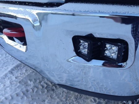

Rigid Dually Fog assembly
There was someone asking about if any one has installed the rigid dually fog light bracket. I installed the brackets and 2 sets of duallys (1 set of spot and 1 set of flood) on my 2013 and then removed and re-installed on my 2014 as well. I have been very happy with them and use them on my commute home from work which is mostly dark county roads and almost always driven after dark, at least that is what it feels like this time of year
. The install was very easy and took less than an hour. I wanted to make sure they worked with the factory fog light switch so I purchased a fog light extension so I could solder the 2 connectors from the duallys to the extension and then just plug the whole assembly into the factory plug. The extension I purchased needed some extra water proofing so I put liquid electrical tape around the back of the wires going into the plastic housing. When attaching the duallys to the bracket I installed the spot on the inner part of the bracket and the floods on the outer part. I had marked my factory fog light beams on my garage door and made sure the spots where a little below the factory spots and have very even and wide disbursement.
Sweet. I've been looking at doing that mod but wasn't sure. Loooks good
