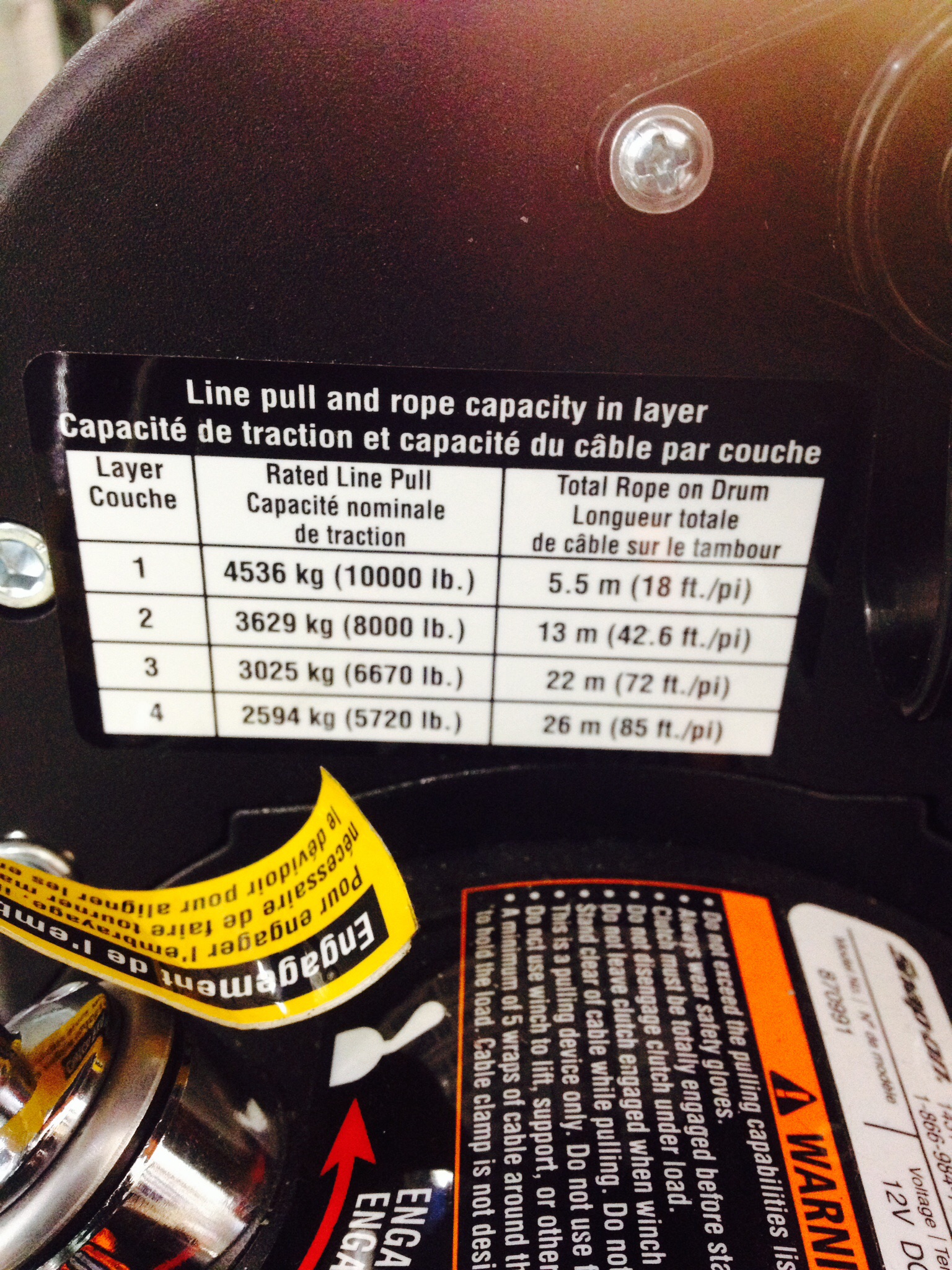

Took this pic to show the difference between the first and the fourth layer on a winch as far as pulling force is concerned. This is what Cactus is talking about. This label is on a winch I saw in Costco. I thought it was worthy noting that the reduction of pulling force is almost cut in half due to torque increase on the load side on the fourth layer.
Spooling it in with the truck in neutral should be ok. If you spool it In under too much tension, when you free spool it out it can slip/ spring back to a neutral position causing what's called " a rats nest". If that happens you may not be able to unspool your cable without cutting a bunch off. I would spool it in under human tension and mildly snug it up against the fairlead. If you have synthetic line then "Rats nests" aren't possible because there is no spring tension and/or stretch in the line. If steel cable is wrapped under tension due to a winch extraction, unspool it with reasonable human tension while pulling it out and then rewrap it. With new steel line installation, it should be spooled with about 1800 lbs of tension or 1/10 th of line rating so as to help give it shape memory and give it an initial stretch to help unlay the wire fibres.
