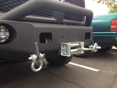

So does anyone have the Prolink on their wagon? Will it fit inside the factory winch opening? Thinking of getting one of them, I think the Prolink looks better than the flat link, gives it a tougher/off road look instead of the clean look. Ill also pick up a pair of shackles since Im at it.

I have the prolink xxl and can agree that it doesn't fit snugly. I just leave a little slack in the line though and it works out fine. I'l take some closeup pics when I get home.

Sorry for the late pics. Got home late last night and had to wait on daylight to get some good pics. Here's how the prolink xxl looks on my PW.

So the XXL will fit, but just barely? Is it really needed on our trucks? I know it's nice to know it will never fail for your purposes but nearly $60 more for something not necessarily needed is too much for me. And the shackles do seem to be right on the edge of not enough for our trucks. Bubba shackles have a wider variety that are more than enough for our trucks.

Yes it barely fits. I haven't pulled it too snug against my bumper yet for fear of damage to the bumper.
