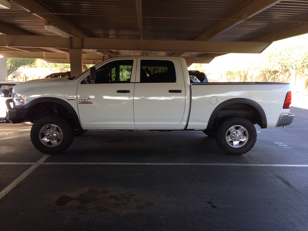

I have the 2 inch Mopar kit on mine and it's completely level

x2SheepdogOutdoorsman wrote:I have the 2 inch Mopar kit on mine and it's completely level

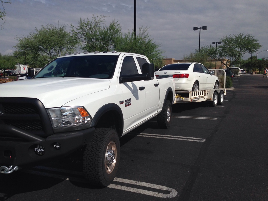

Do you haul or tow anything?
Personally I wouldn't go over 1.5"
Towing or hauling will squat your rear, which is half the reason its nose low from factory. A full 2" or more will make you nose high with a load. Will be blinding on coming traffic at night and also look overloaded due to being nose high.

I haul ... No squat ...

Hmm... I stand corrected on that... mine sits level with the jeep attached so it would be a tad nose high then.

I think a lot of it depends on the trailer. I see no squat hauling heavy loads on mine, but if I loaded my bed I'm sure I'd see some.

I'd try loading your jeep backwards to put the engine weight over the trailer axles, but still pull the jeep all the way to the front of the trailer to put some of the weight on the tongue
You definitely want to keep some of the weight on the tongue so there's weight on the rear axle of your truck. Otherwise the combo gets squirly when braking.

Yeah I've had people tell me they load 50/50 but I've never had a problem and would rather err to more tongue weight than.
