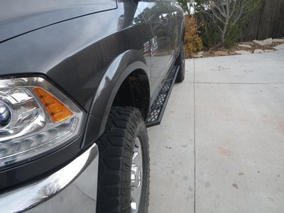

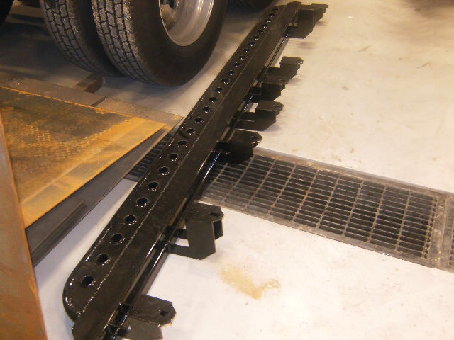

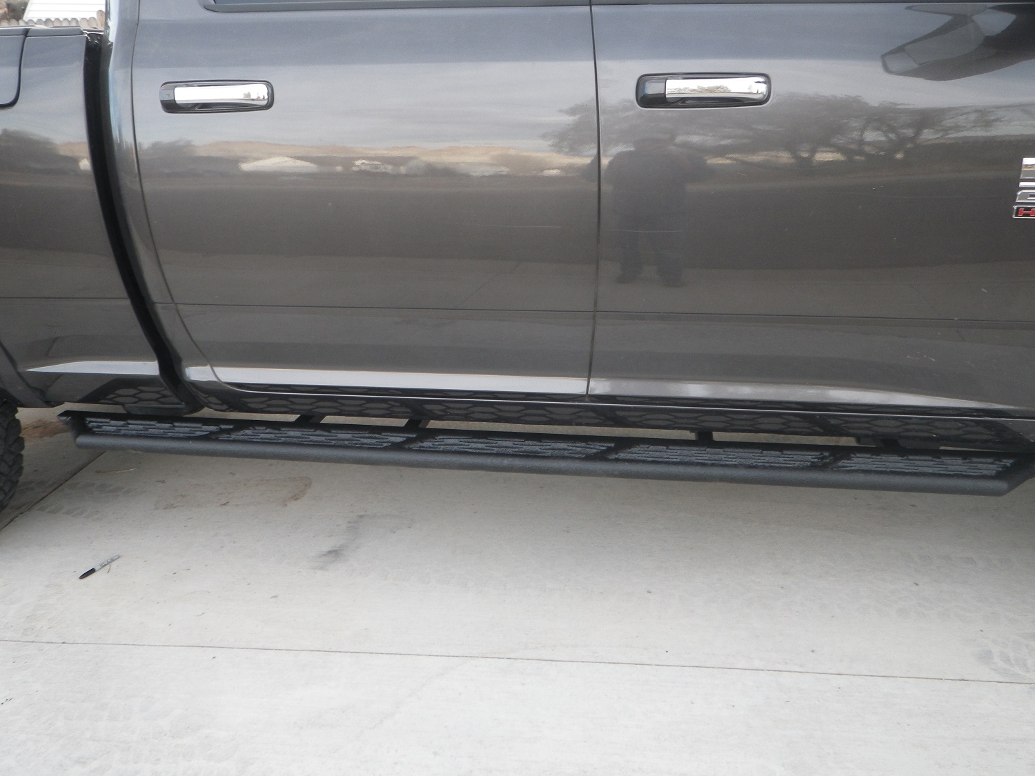

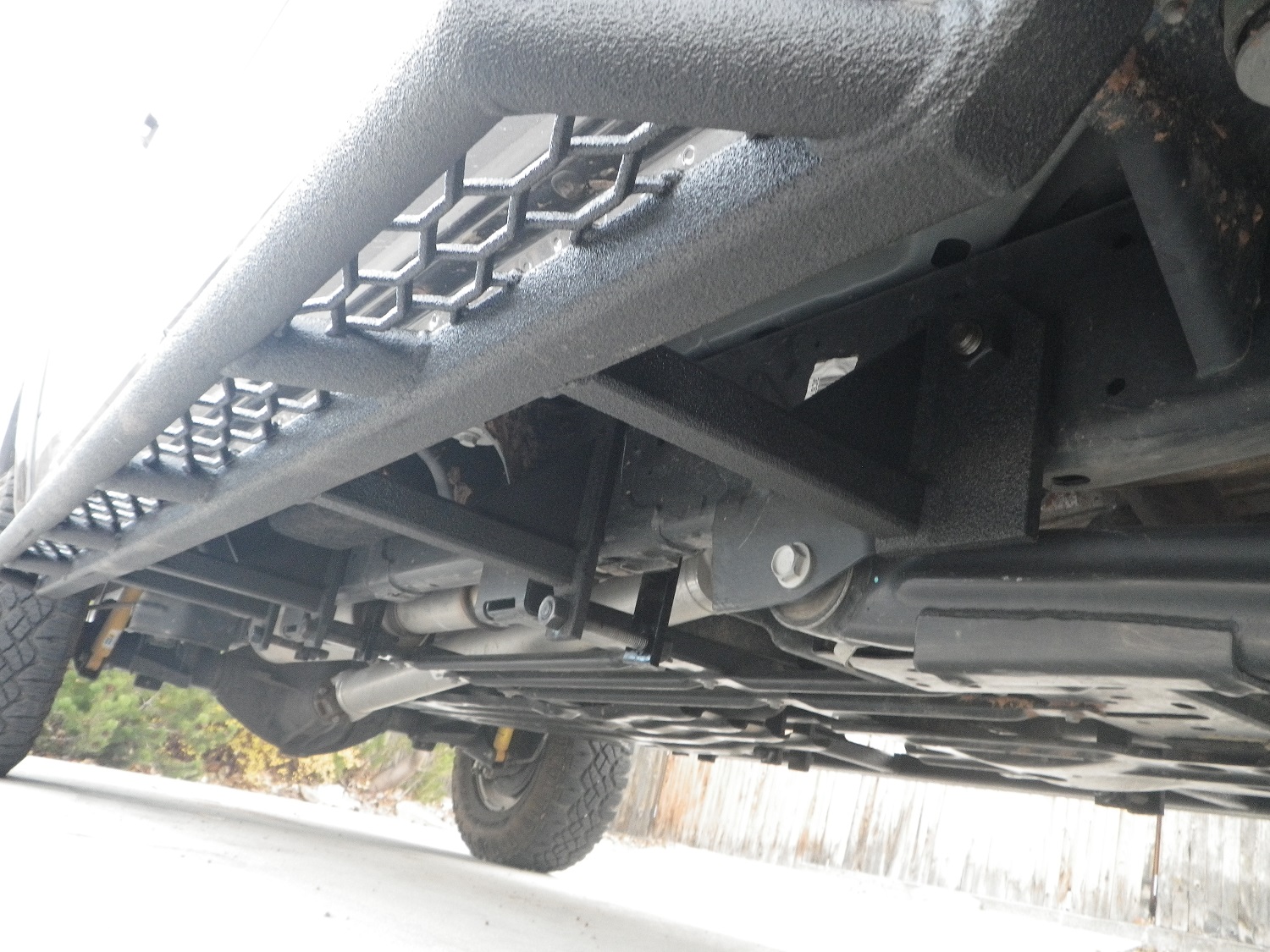

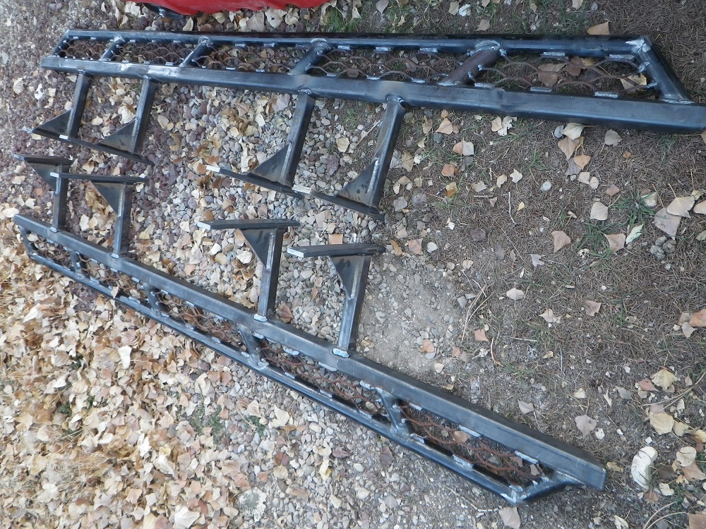

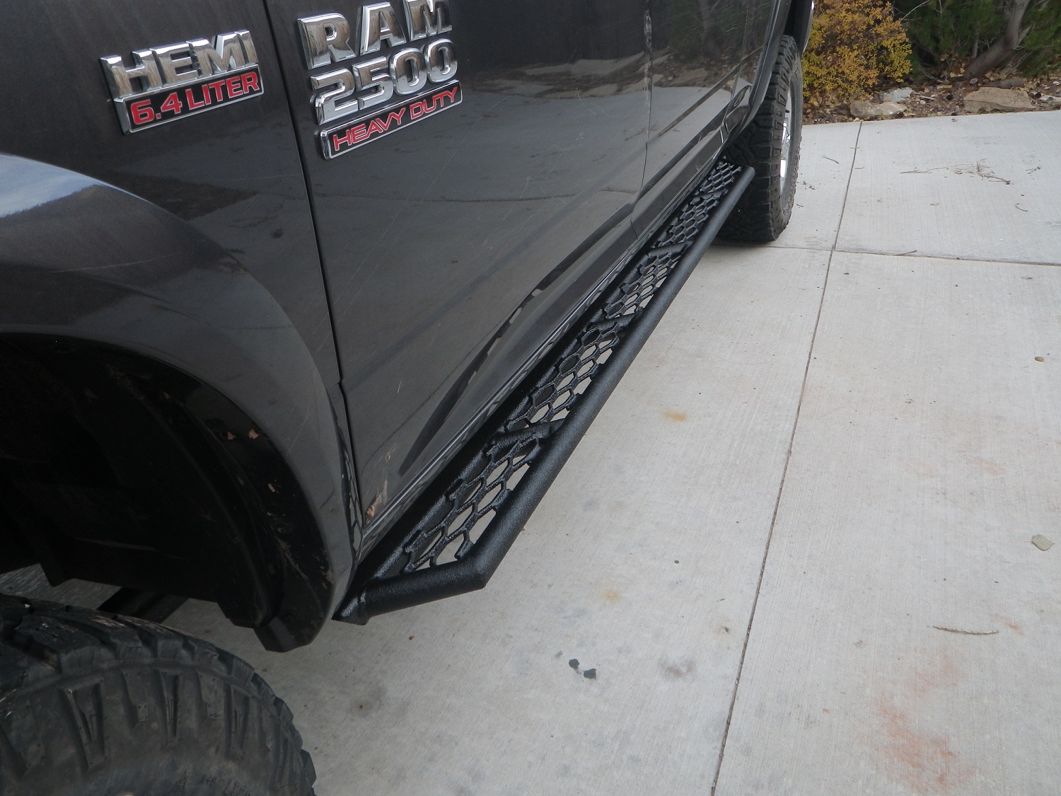

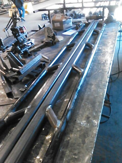

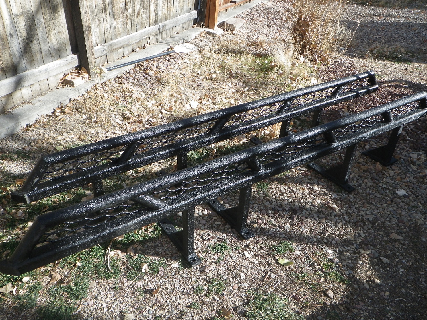

Well I finally got them built and installed, they are similar to white knuckle with a few changes (mounting location and expanded metal inserts) should be just as tough, I used 3/4" studs to mount them except for the front mount which is a 7/8" stud through the frame. The drivers side was a real PITA to install . I know the Line X will get worn on the underside but they look so good right now.

I had a local welding shop build them,I was going to build them myself but then I got to second guessing my welding skills since I only weld on small projects.
There is $200.00 in steel, $500.00 to weld them , and $200.00 for the Line X. The fasteners (studs) I already had, I did price 5/8" x 4" grade 8 bolts and they were close about $8.00 a piece with nuts.I didn't price washers . So that is over $100.00 for fasteners. So my $25.00 3/4" drill bit was the better choice,originally they were drilled for 5/8". So total cost to me was $925.00 That is US dollars for our Canadian friends ;)
