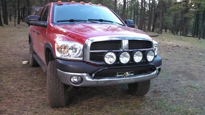

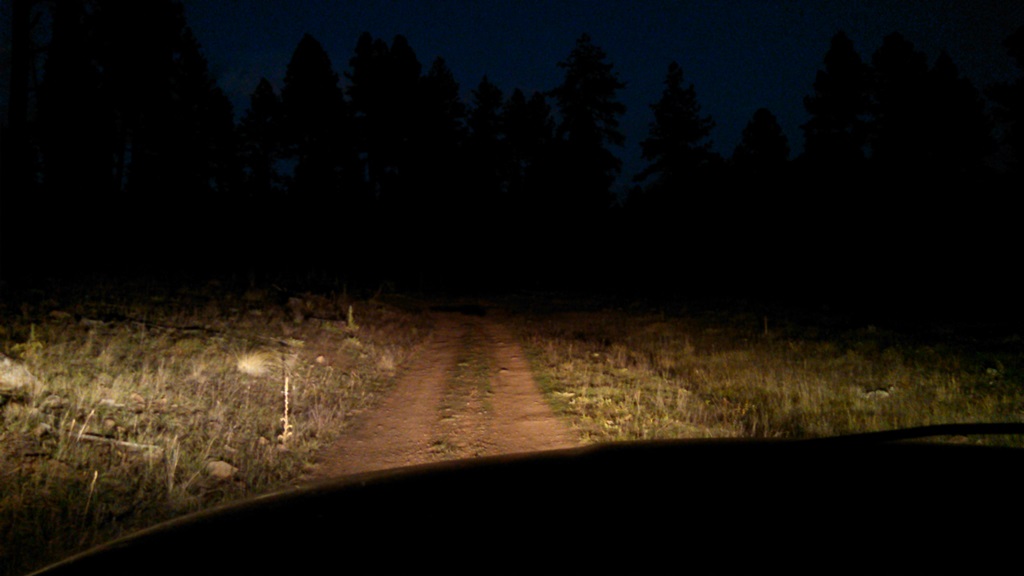

Cactus Red has four KC #851 Driving beam HIDs on a RED Inc. light bar w/ the left and right light canted out at 15 degs. The factory headlights use Phillips X-treme 65/55W bulbs, the factory fogs use converted Phillips 9011 HIR1 65W bulbs.
Tried tonight to get some photos while we were up near Williams, AZ with the phone. These are the best of what I took, and they really don't do justice to any of the lights...
Fogs and low beams: Low beams: High beams: High beams and KC #851's: The only problem with the HID's is that once you turn'm off, the stock lights are truly dim...
When the 9011 HIR1 bulbs burn out, I think I'll go with the 9012 series to eliminate the extraneous light emitted by the non shielded bulb.
Mark
The HID's are switched via an On/Off/On switch via a relay with the upper position tying into the high beam circuit to turn them on, the lower is just on. The relay is detailed in the Cactus Red mod thread - it works with the CanBus system with no pulsing, flickering, or buzzing like the typical Hella type of relay does.Tried tonight to get some photos while we were up near Williams, AZ with the phone. These are the best of what I took, and they really don't do justice to any of the lights...

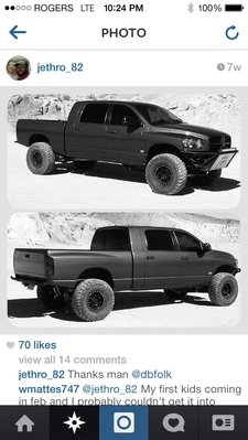

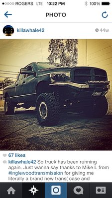

Honestly the pro comp lights I had on my old truck-the 130w models they were 8" were freakin bright they drew a lot or amperage though.....
Sent from somewhere your not
almost 11 amps each lol if I were you id look into a small 30" gg. Light bar maybe even curved the price point is very good and a lot of their products are lifetime warranty....? GG lighting I see then advertise a lot on Instagram and they have their lights on some pretty capable rigs. Like I said for price point you can really beat 250$ for a curved 40" dual row bar.... Sent from somewhere your not

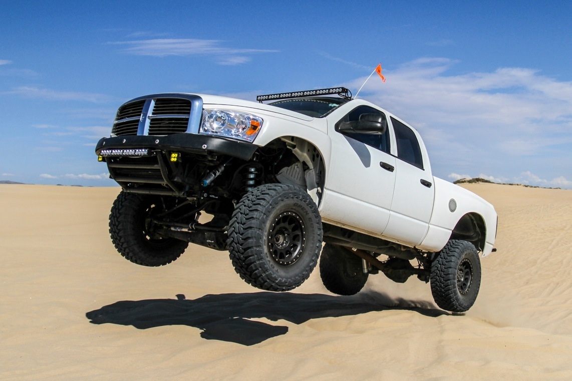

A 30" lightbar is pretty bright juday. Your right lots of "bro trucks" run light bars....lol
I don't think you'll have to worry about us judging you if you put one on...:p I am a fan of old halogens though too but led light is very clean and white naturally. Sent from somewhere your not
Re: Off and On Road Lights
HAHAHA! Well, around my neck of the woods, those types of off road trucks don't exist. The only sand we see around here is the kind that are in the kid's sandbox, or thrown on the streets in the winter.
And, if someone is willing to let one of those Baja Design Onx light bars go for about 1/3 the price, then I'd probably think about it. Then again, I still like my lights to be round in shape....
