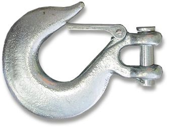

Also, is it true that if the hook were to fail it would travel in the direction away from the opening? I was told when I first started wheeling to always point the hook to the ground. So the closed side to ground.

X2jeep_boy02 wrote:Also, is it true that if the hook were to fail it would travel in the direction away from the opening? I was told when I first started wheeling to always point the hook to the ground. So the closed side to ground.

That's true, but... If the hook was pointing towards the ground, wouldn't the open side (side w/ clasp) be closest to the ground & the closed end closest to the vehicle body?jeep_boy02 wrote:Also, is it true that if the hook were to fail it would travel in the direction away from the opening? I was told when I first started wheeling to always point the hook to the ground. So the closed side to ground.

I didn't necessarily mean the "pointy end of hook" basically just as the photo shows the curved side of hook down and the open side up.

Ok, we're tracking!jeep_boy02 wrote:I didn't necessarily mean the "pointy end of hook" basically just as the photo shows the curved side of hook down and the open side up.
