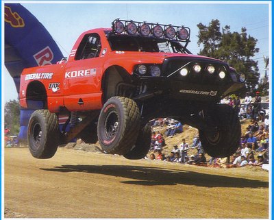

Here's a pic of the KORE fenders on a 3G:

Ducky's Dad wrote:Here's a pic of the KORE fenders on a 3G:
Those are pretty sweet! Hmmmmm lol. Fiberglass breaks to easy when I'm squeezing thru tight spots but something to think about when I go 42" tires next lol.
