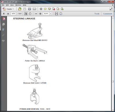

Here are the tools that the dealer uses, I tried a pickle fork on mine and it did not work very well.

Re: Need some help on lift install...
Post by 05PWrockcrawler » Fri Jun 13, 2014 9:57 pm
Pickle fork and big hammer worked great for me.
