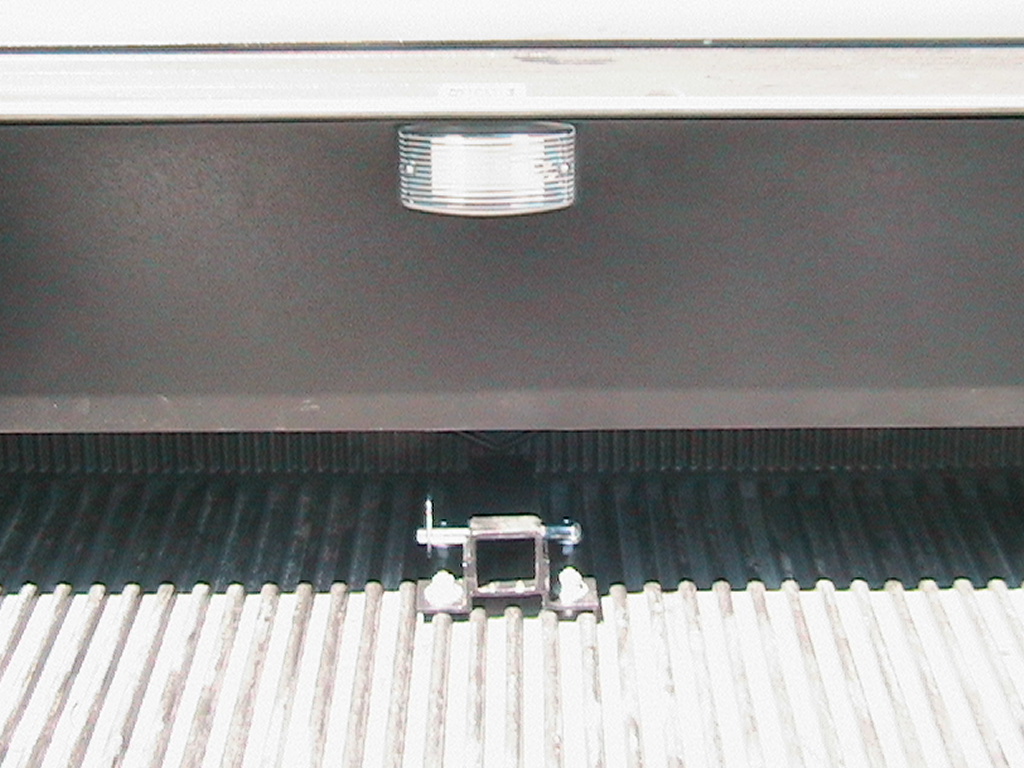

Bedsides= tree magnets! Seriously considering a rear winch!

I'm thinking about getting a receiver mount one for the few times I might need one. May beef up the stock receiver so it will take more of a side load at the same time.

A More Power Puller is an option I've considered. Used with an extension and pulley, it will do the job for the few times I've needed one.

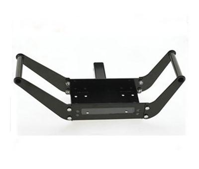

I usually travel alone and I've been contemplating putting this together for about $600. Some times you just can't keep going forward.
http://www.4wheelparts.com/Winches-Winc ... S%2fB97281
http://www.4wheelparts.com/Winches-Winc ... =S%2fB2811
http://www.4wheelparts.com/Winches-Winc ... S%2fB35210
- images.jpg 2.jpg (14.62 KiB) Viewed 5567 times
- images.jpg (9.11 KiB) Viewed 5567 times
- images.jpg 1.jpg (14.39 KiB) Viewed 5567 times

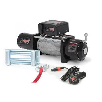

Re: Bedsides= tree magnets! Seriously considering a rear win
We have an XRC8 Comp on the Jeep, and it's a strong winch. That would make a good setup for you. I would however, suggest you buy welding cable and make your own cables. To me, 1, 0, or 1/0 would be the minimum gauge wire I'd run. The wire above looks like 4 or 6 to me!
Power Pole connectors are available to handle the connection at a much higher rating too. http://www.andersonpower.com/products/p ... -hp-b.html
You know that's a pretty cool idea and it would fit perfectly in a tool box. I may consider this combo down the road as well for my rear receiver.cruz wrote:I usually travel alone and I've been contemplating putting this together for about $600. Some times you just can't keep going forward.
