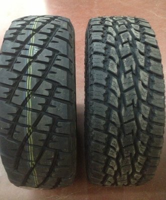

This is what I'm running summer and winter. The one on the right is the toyo at 2 extreme it is available only in 285/75/17 and 315/70/17
Second picture is the regular at2 beside the extreme. Different tire sized but the voids on the extreme way bigger. And load range E
