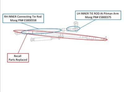

When I had my recall done I went ahead and replaced the old, worn inner tie rod ends before I took it in since they where going to do an alignment anyway.
I got the Moog parts from http://www.summitracing.com for around $100 and put them on myself, not bad getting a whole new front end for $100 here's a diagram for your viewing pleasure.
