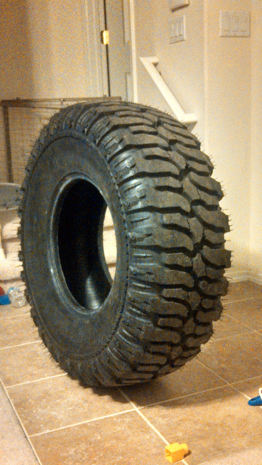

Didn't really need them but just scored a crazy deal on a set of Interco 37x13.5x17 M16's. Headed up north to pick them up tomorrow

Yeah she was strangely ok with it, especially once I convinced her what a good deal they were. They were actually at a Discount Tire that came off a hummer limousine after about 50 miles when they realized they rubbed with people in it, if anyone is around Colorado Springs they said they have another set of 37x12.5x17's they're trying to get rid of.
