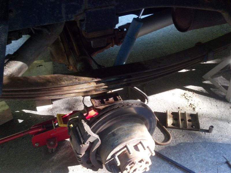

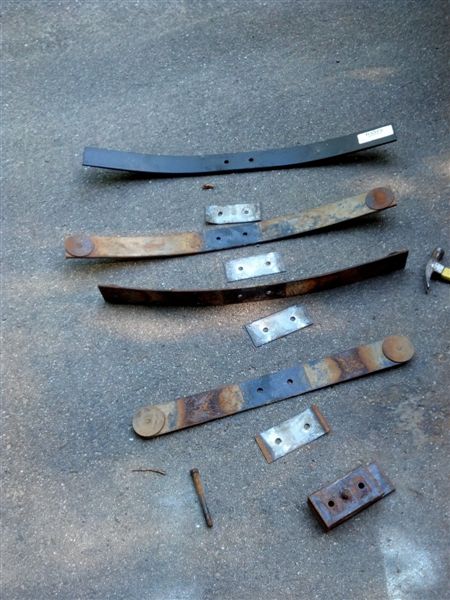

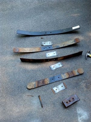

Ok, so I know it's not the preferred way to go and I've been planning on installing new leafs for awhile, but never pulled the trigger and knowing I'm getting ready to move funds won't be freeing up for a while and I was getting really tired of the sag in my rear end.
So... I installed a 2" add a leaf from skyjacker yesterday. It went ok. I did it by myself in my driveway in about 4hrs. first side was about 3 hrs second side about an hr.
I ended up leaving the springs in the truck and adding the leaf right in place. It looked to me that I wasn't going to be able to get the bolt for the front of the drivers side leaf out without dropping the gas tank so rather than do that I did it in place. Sorry for the limited pics but I was in a hurry.

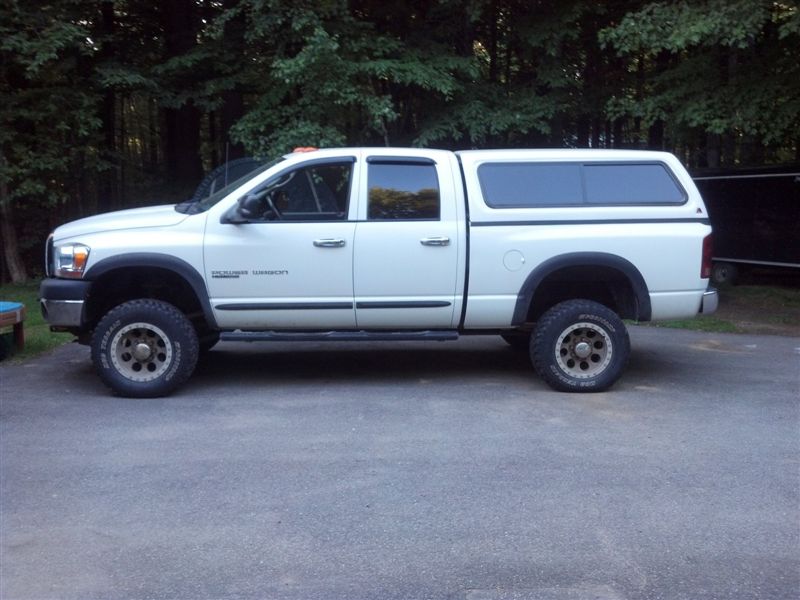

It ended up raising the rear about 1.5" and definitely made it sit more level. Time will tell how big a mistake it was...
