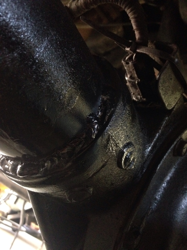

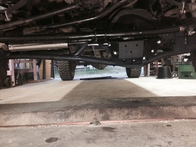

I wonder if just welding the tube which was leaking would have fixed this...I had some buddies with mustangs and older hot rods who had leaking tubes at the diff and drained them cleaned them real well and just smashes them with a lot of heat and beads around the whole axle (however these axles did have axle seals at the ends of the tubes not on the diff like the 9.25 but with enough care it could be done....
Sent from somewhere your not
old sole mopar
Posts: 183
Location: Kimberley BC Canada
Re: gotta little problem
Post by old sole mopar » Wed Apr 08, 2015 9:47 pm
Full welds on the tubes and extra plates/trusses over the banjo. If this happens to anyone else you will be fixing it on your own dime. So strip it and twist the tube back . Put new seals in and it won't happen again.
Posts: 2970
Post by 2wagons1driveway » Wed Apr 08, 2015 9:56 pm
a truss seems like it's not a great addition for some people and their wheeling styles but the 9.25 is so crappy and weak with those plug welds it's great for added reassurance and for the 3/4" of ground clearance you loose (if properly installed) is worth it...
