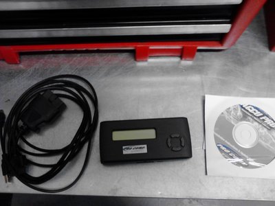

I just put on a set of 35's this past week and went to the dealer was told the same thing about factory tire sizes only the technician said on Chrysler vehicles tire and gear only adjustments are not done on the PCM they are part of a separate module so you don't need full programmer or a complete reflash to make changes.
4wheelParts sells a Pro-comp a calibrator (a re-branded Hypertech) that just does tires and gears adjustments are in 1/4" increments from 20" to 40". I picked one up measured my tires which came out to 33 1/4" (the tire spec said 34.5" at 65 psi I am at 45 psi so I lost 1 1/4" in height I guess) made the updates and all is back to normal.
The truck seams to accelerate and shift better, I've been running slightly over sized tires for nearly 5 years and never adjusted anything before and forgot how it really drives.
