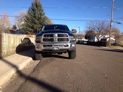

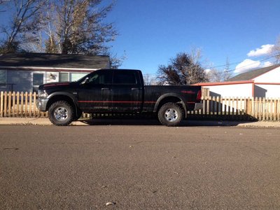

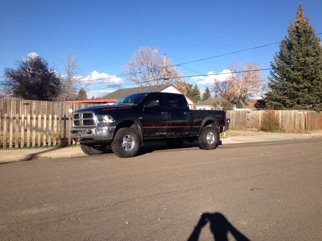

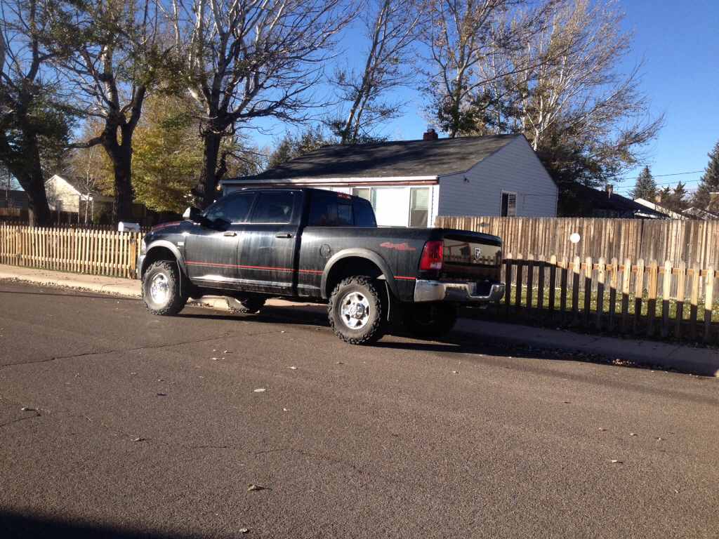

Degss wrote:Carl still wanting to see better pics of this. From a couple angles if you could. Would you say it's a ride improvement even with the stock shocks. Getting ready to pull the trigger on this same setup, put with carli control arms would do thuren arms but do not want to wait. Also anybody find a cheaper adjustable track bar that's just as good. What's the difference?
Well here you are. Sorry the truck is dirty. Damn weather. Sorry that it took so long been crazy busy with work kids and hunting. Oh and there is a slight grade in the street down hill right to left.
Sent from my iPad using Tapatalk - now Free
Re: Front suspension Poll/?'s
Looks great! And a Power Wagon owner should NEVER apologize for a dirty truck.
That truck looks awesome!
