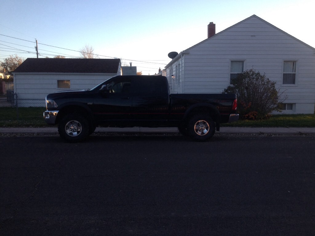

Done! I'm spent. Did it all in a driveway no special tools. Hell I didn't even use the new bolts for the control arms to replace the one you supposedly have to cut out. I did use 2 motorcycle straps, 1 for the spring and 1 for the shock. Looks great and dead level. Ride quality seems to have improved as well.

Oh ya and most importantly have have full left and right turn back with 1/2" to spare!

Did you keep the stock shocks,how does it ride and could you post some better picks. Thanks

Kept the stock shocks. It rides much better now though I haven't driven it but a couple block. I did notice it though. Will get better pics up tomorrow when there is a little better light. These Thuren arms are wicked cool!Degss wrote:Carl
Re: Front suspension Poll/?'s
Looks great!

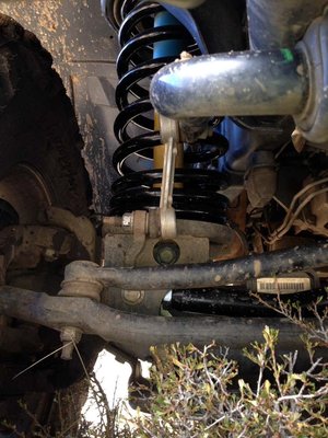

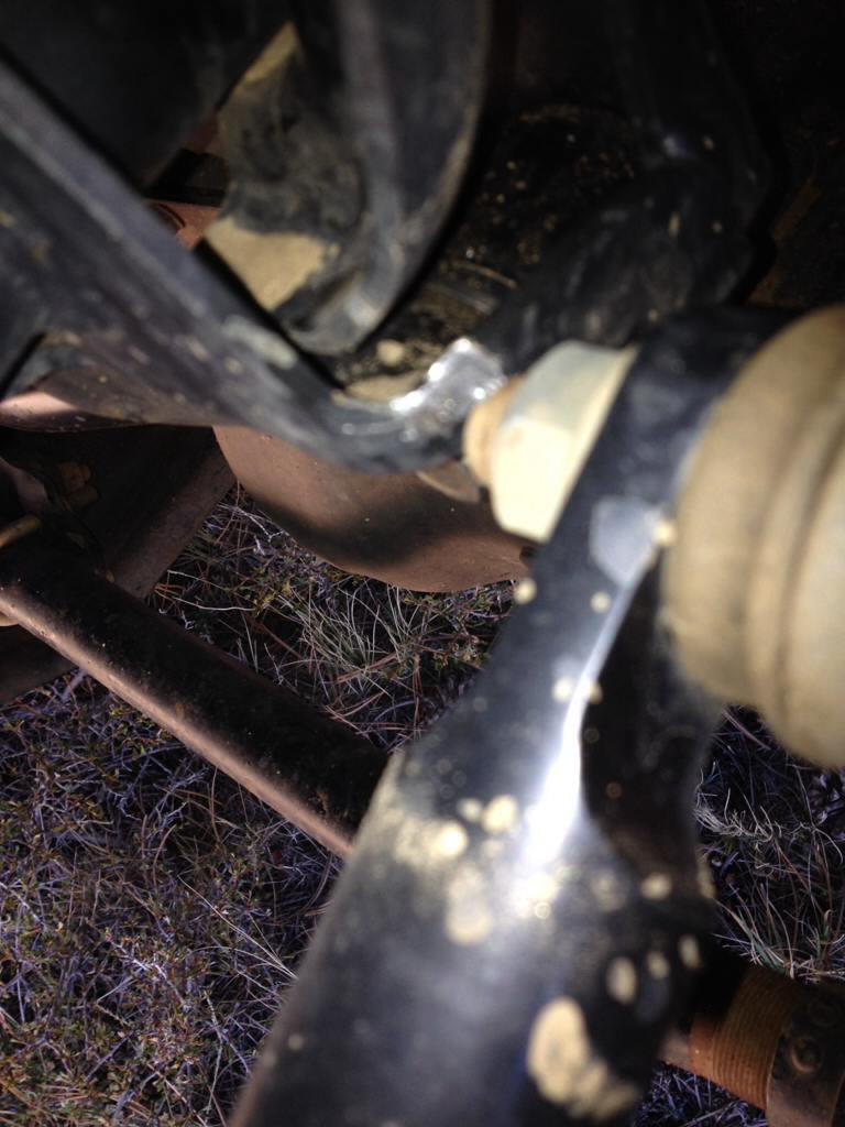

In those pictures it looks as though your sway bar seems to have moved quite a bit. I don't know why though.
The thing was unable to be driven at speed with all the issues in the steering geometry and was not even as good as a factory PW with no mods when off road. I think this says tons about their products and I will not waste my time with any of their products if this is their best attempt at a show performance demo truck. Just my opinion but it is worth mentioning. Pure performance my ass!
I noticed that too. The end links- One side seems to be much more vertical than the other, or are they always that different ? IDK ?
- Posts: 262
- Location: Cheyenne,Wy
The away bar did shift. I can tell by we're mud is and where it's clean? I'm at a loss here. Not sure what to think.
