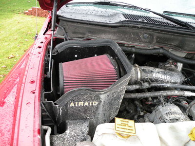

Post by RustyPW » Thu Jun 07, 2012 5:37 am
I'm using a Airaid CAI with mine. I modded the Airaid box to fit with the snorkel. Didn't take much to do it.

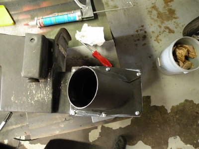

Post by BlkWgn » Fri Jun 08, 2012 2:01 pm
As long as you take your time with the template it is not too bad. I have some photos and info from when i did mine. Should be in my build thread in my signature

Post by RustyPW » Tue Jun 12, 2012 2:44 am
Here's a few pic's of my set up. I'm using an Airaid MDX CAI.

Post by Montana Dan » Tue Jun 12, 2012 10:34 pm
Thanks Rusty. But my air box isnt as nice as yours. Its pretty open at the bottom. I will post picks when i do the offical install. Come on UPS guy hurry up!
