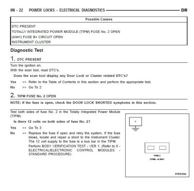

Here is a page about checking codes and the fuse related to the door locks...
