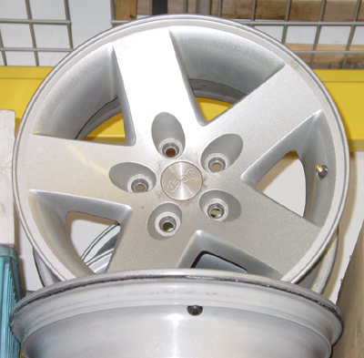

Damn, that took a lot of searching, but I found a picture of a Jeep rim, but not a PW rim. Anyway, the bead seats on the '05 to '09 PW have very large double bead seats not unlike the one show. The old style TJ rim shown had larger ones inside and out than we do. The NHTSA mandated double bead seats a few years ago, but they are very shallow in comparison. The old TJ rims gave most tire shops fits - they are tough to break down. On the PW rim, the inside and outside bead seats are both similar in size, the mandated ones are quite shallow.

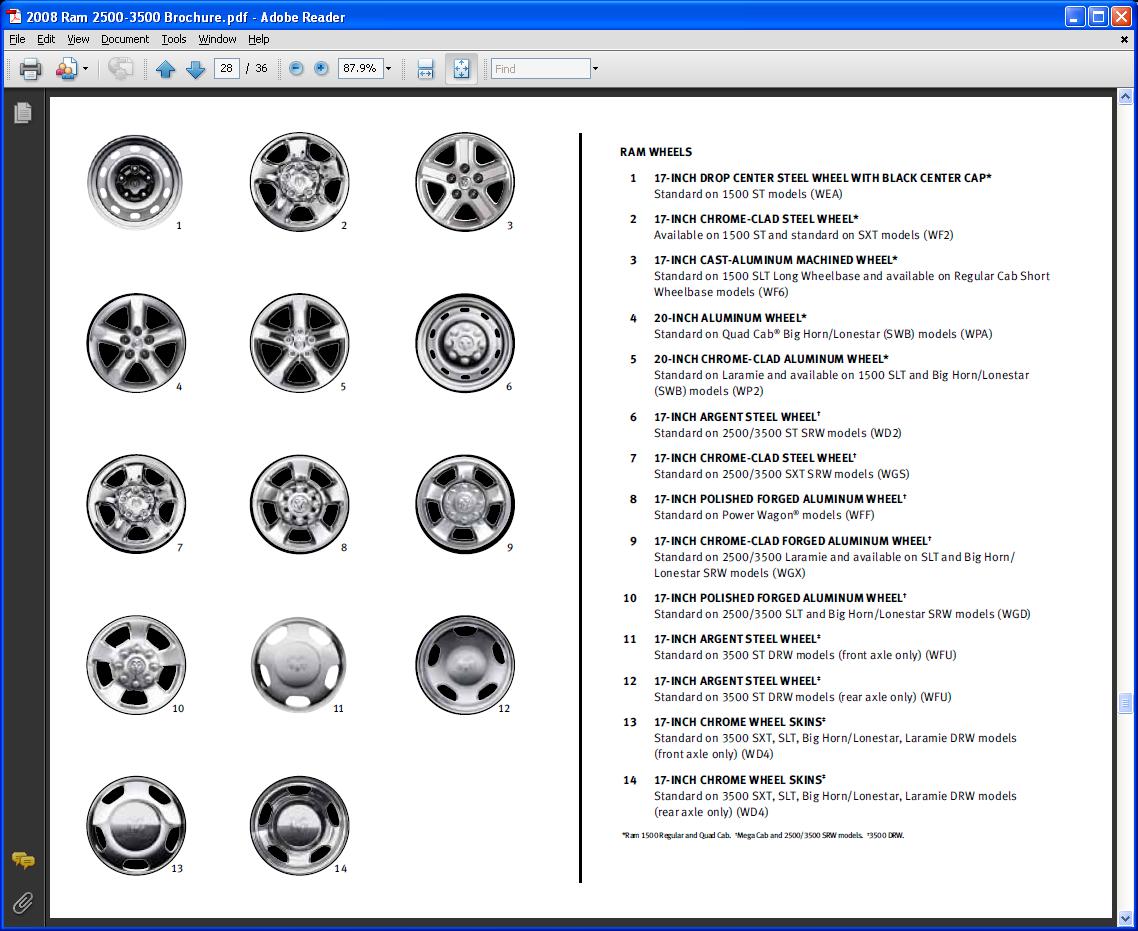

There was no factory option for PW wheels on other models, but there are other wheels that look very similar but don't have the bead retention lip inside.TwinStick wrote:I believe that you could order the PW rims separately, as its own option for certain years.
This is from a 2008 Brochure wheel #8 is the PW wheel #9 and #10 look the same but aren't they are for other models.
