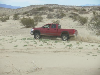

Low, low pressure is required, as is a light foot. I've been in some pretty soft desert silt, IMO, worse than beach sand, and at 10 to 12 PSI, have towed race vehicles off the course without a problem. I'd start at 15 PSI, see how it floats, and adjust downward if needed. Worst possible thing is too much throttle - the axle hop will dig you in almost instantaneously.
EDIT:
Found a photo from the Parker Challenge of desert silt. I'd pulled forward into the stuff, and the truck went to the rock rails in a few feet. I had the tires at 20 PSI, dropped to 8, and backed out with a few tries. I'd back a little, pull forward a bit, do it again, and the stuff literally filled itself back in under the tires - weird...
It's hard to even walk in it.
