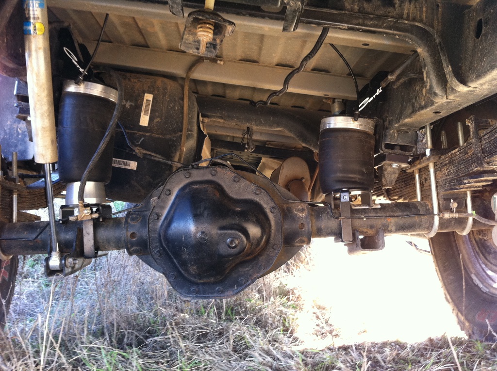

I don't know campers that well, but I believe this is a truck camper (ie in box pop-up). With that kind of dry weight you will definitely be experiencing some sag, and for piece of mind I would get helpers of some sort. I'm biased towards air bags myself.
Re: Do I Need Helper Springs With a Pop-Up Camper?
Timbrins will work and are easily removed when not needed. The do hinder articulation (compression). I would suggest an air bag system if you plan to go expedition style.
The Carli bag system is the top of the heap as far as performance. There are others but I do not know much personally about them. I use Timbrins for heavy loads and remove them when going off road or not hauling heavy loads.

He has a set of the Carli long travel's, and from what I've seen of his rig on various roads and trails, they are pretty much a requirement. The way the camper is setup, all the weight is on the same side as the gas tank on the truck. As I recall he runs about 50 PSI on the d'side bag, 20 on the p'side bag to keep it level.

Is the Grandby used ? If you are buying new, the Hawk model would be a better fit for a short bed without sticking out beyond the bumper. As far as air bags go, you can adjust them for whatever weight you are carrying. Air bags will also help control sway (rocking back and forth from side to side). Firestone, Air-Lift brands are approx. $300 and are easy to install yourself, Carlis are $800. I've used Air-Lift bags on my last 3 pickups hauling campers and have never had a single problem. The one thing I like about Firestone and Air-Lift is they mount further out on the axle and in my opinion will provide more leverage helping control sway. Some will say that they restrict articulation as compared to the Carlis, maybe, maybe not, but I'm not out rockcrawling when using my camper.

If you are gonna keep it in the back all the time, I would recommend these instead: http://www.thecarlisuspension.com/dodge ... gpack.html the Heavy Duty Leaf Springs. The 3" ones are actually only a 1" lift for Power Wagons, they would do-away with the 2" lift blocks under stock spring pack.

The springs are great, but they can't compensate for the water, battery, appliances, etc, that are all on the left side of the camper. The load is seriously off center. Both would be ideal!

If your PW is stock as far as suspension travel you can save alot of $$$ and use firestone air bags. I have tortured mine for 7 years off road with HEAVY pop top camper, and they work great. The Carlis are Beautiful but not necessary unless you have xtra travel in your suspension. I would sugest getting the on board compressor with gauge and dual switches. On off camber trails you can air up the low side and air down the high side. Also great for leveling camper for the night.

If you use your truck offroad, you will not like the firestone airbags. Been there, done that and upgraded to the carli long travel bags. The firestone bags limit your suspension travel to 6 inches or so vs the approx 10 inches you get with carli's. Cactus red, is right on the money with the need for airbags due to the offset nature and dynamic weight distribution of hauling a camper.
