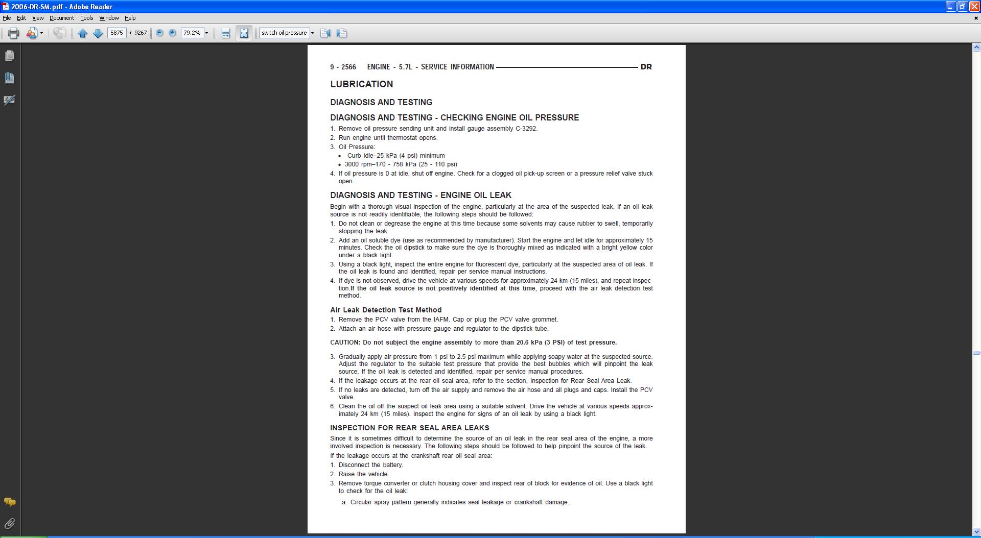

OK I goofed, ignore the previous post that is for an SRT10 only, the SRT10 has the oil temperature sensor not the 5.7.
Here is the 5.7 oil pressure switch location and testing procedure.
Oil Pressure Senor
Oil Pressure Test

I put the new OEM oil pressure sending unit on today. Very easy, you just need channel locks. I really won't know if that was the problem till I put some miles on it. The OEM part # for a 2006 is 5149097AA.... NAPA $52...Dealer $42...MoparPartsOverstock.com around $30 delivered...
