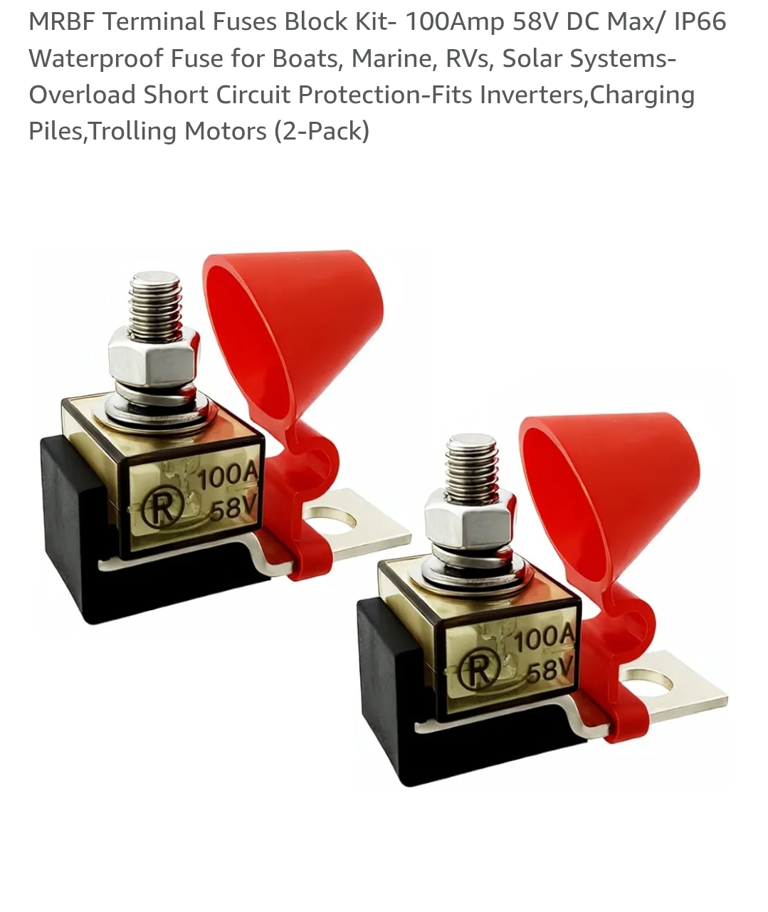

I separated the permanent battery connection from the alternator so I could fuse both runs of wire to the alternator. That way I don't have to worry about relying on the fuse link for protection.
The fuse holders I used
