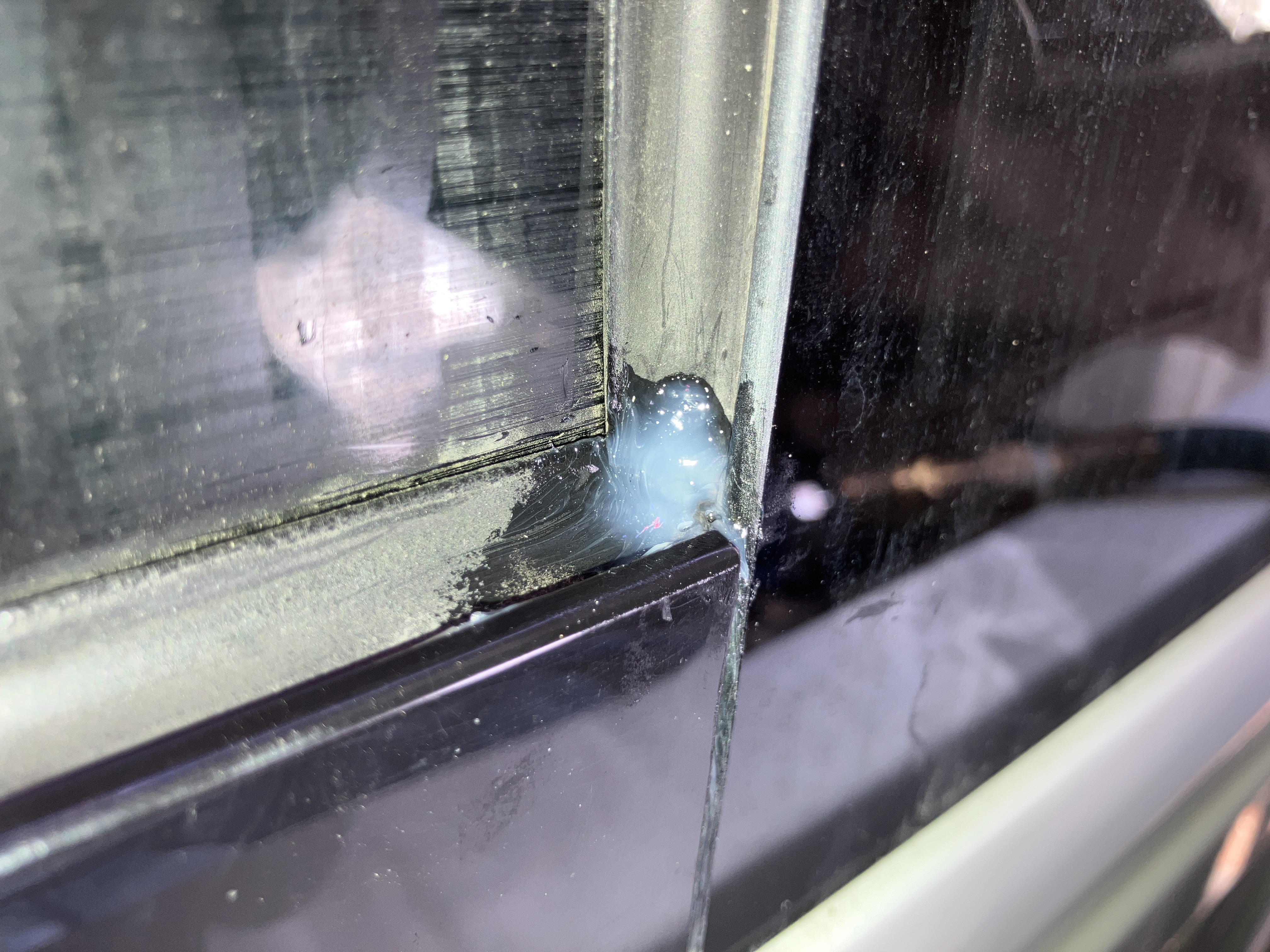

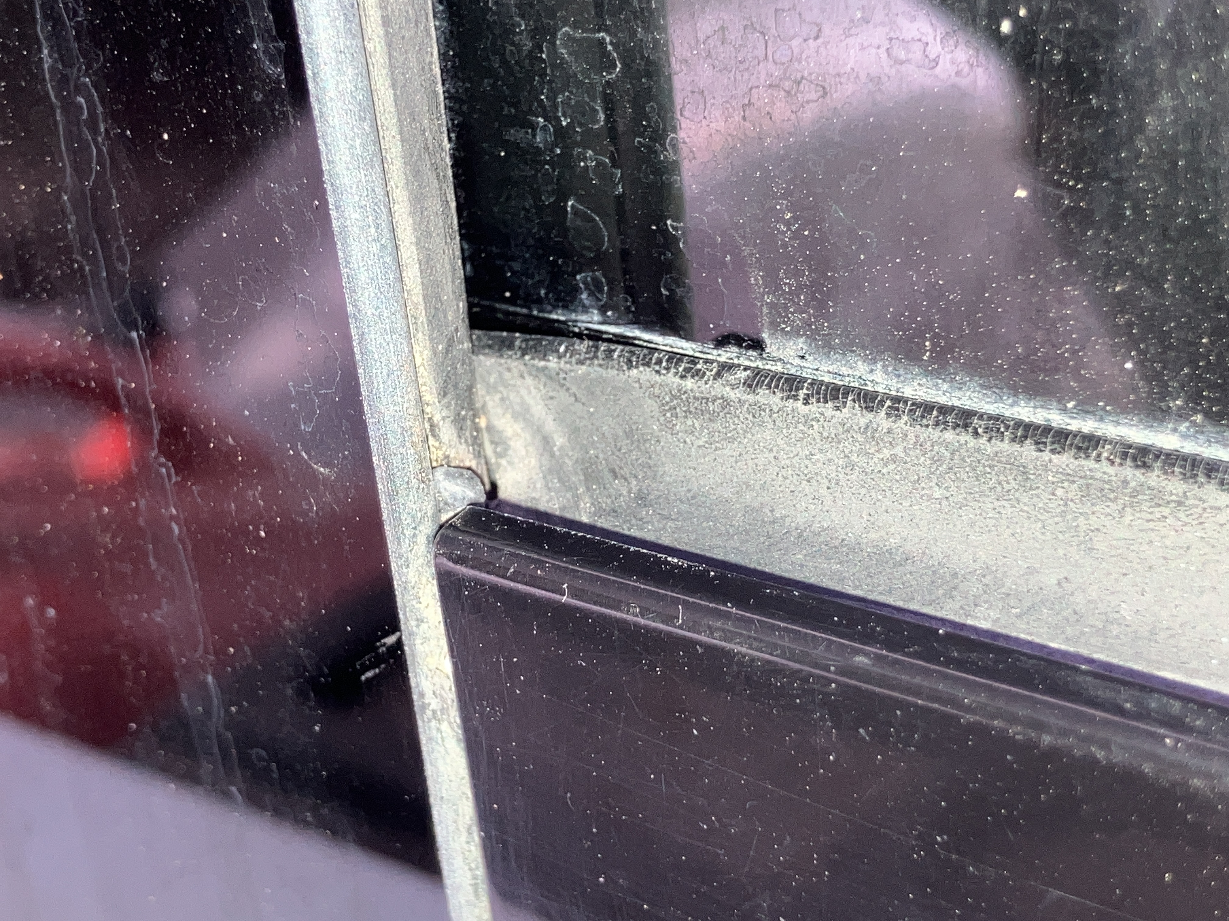

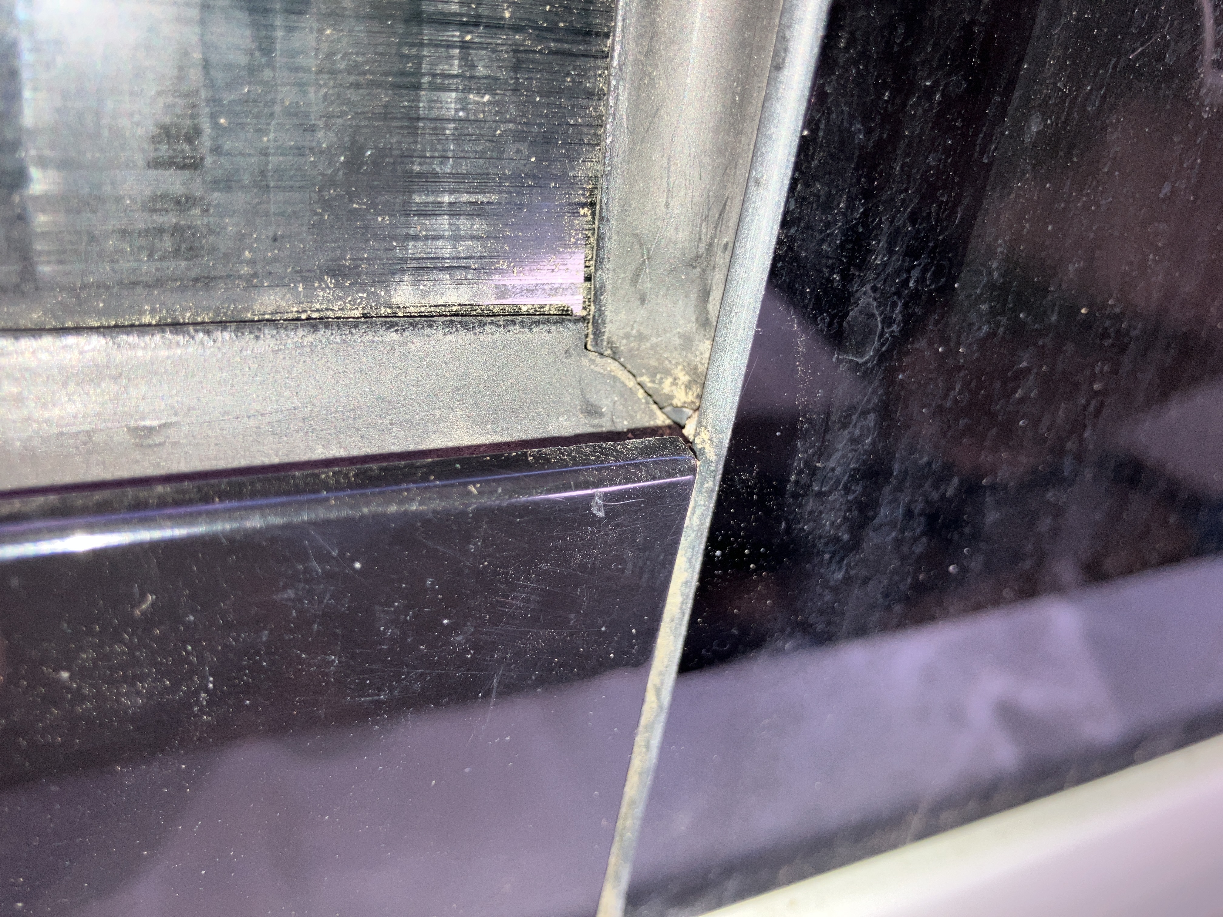

I went to grab my jumper cables from my rear under seat storage area the other day and found them swimming in water.
Looking around for forensic evidence of where the water came from, I found a water stain coming down from the power sliding rear window track. The track itself still had some water in it. Upon closer inspection I found tiny gaps in the lower corners of the weatherstripping for the sliding window. It looked like there used to be some sealant at those joints, but time has taken its toll.
I'm pretty sure this will solve it, but I'm going to keep a close eye on it until it proves itself.
