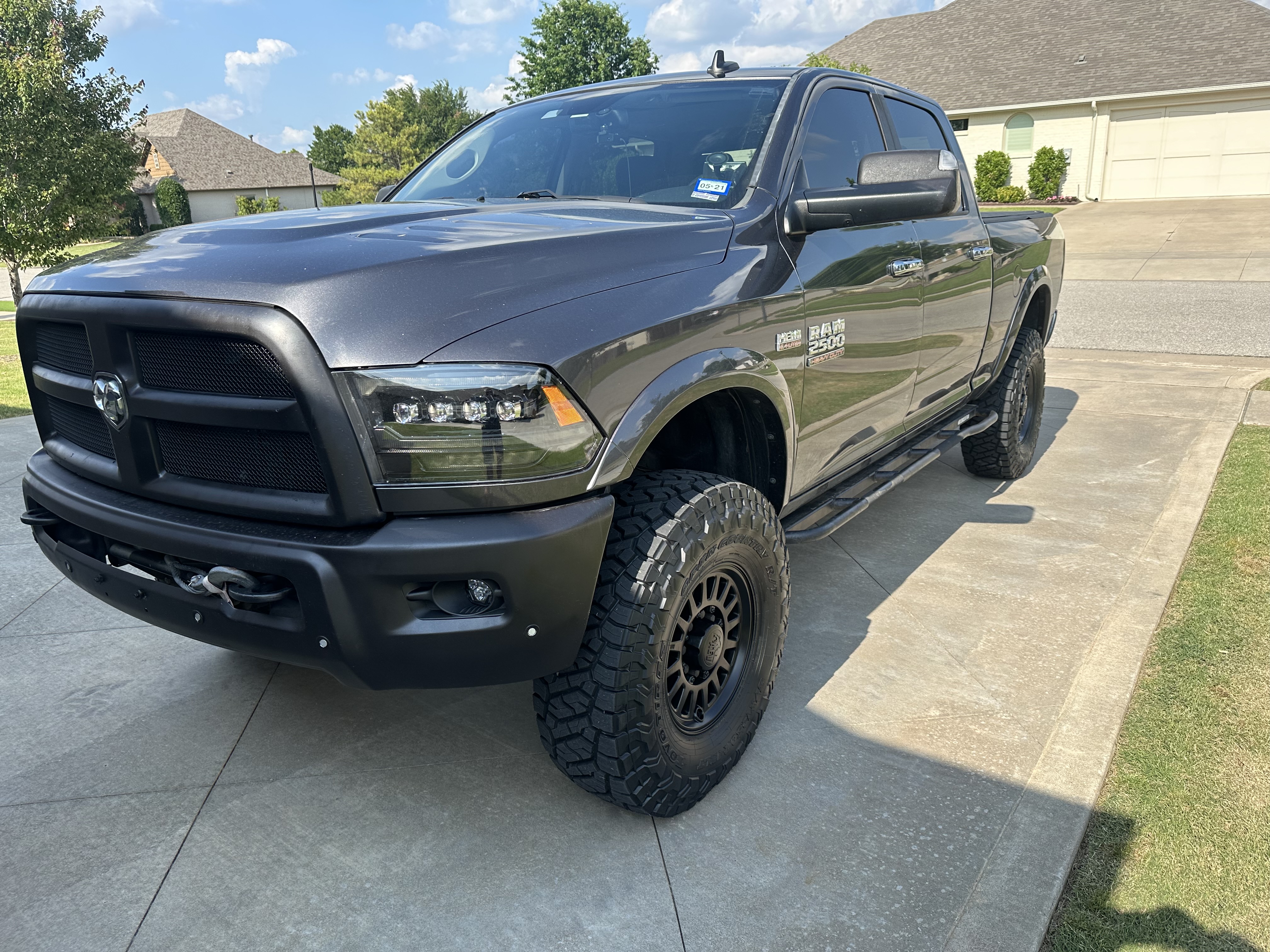

Got the Toyo RT Trails mounted up. 37" LR E. Exactly 2" taller (36.25") than my 35" Toyo MTs. I also got an alignment done (which led done another rabbit hole on if I should go with Thuren specs. Discount couldn't adjust caster anyway but it was generally within the Thuren recommendations, they put too much toe-in according to Thuren.)

The 37”s fit really well with the AEV wheels (and Thuren lift)
Just barely kissed the inner fender liner on one of the ribs, pushed them back with some heat. Only around 2” of travel at full lock, anywhere else they cleared with no effort
Getting slightly better mileage than 35”s with the 5.13s.
If I’m ever lucky enough to move back to somewhere with winter I will run oem wheels with 35”s in the winter so I have room for chains. (I have both in storage)
