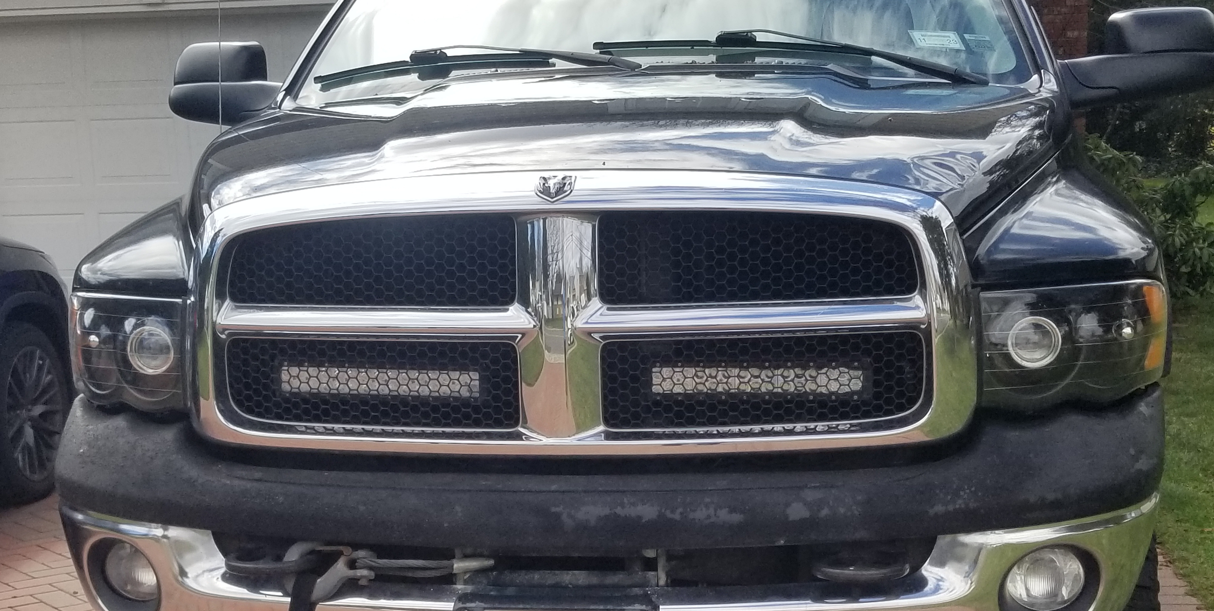

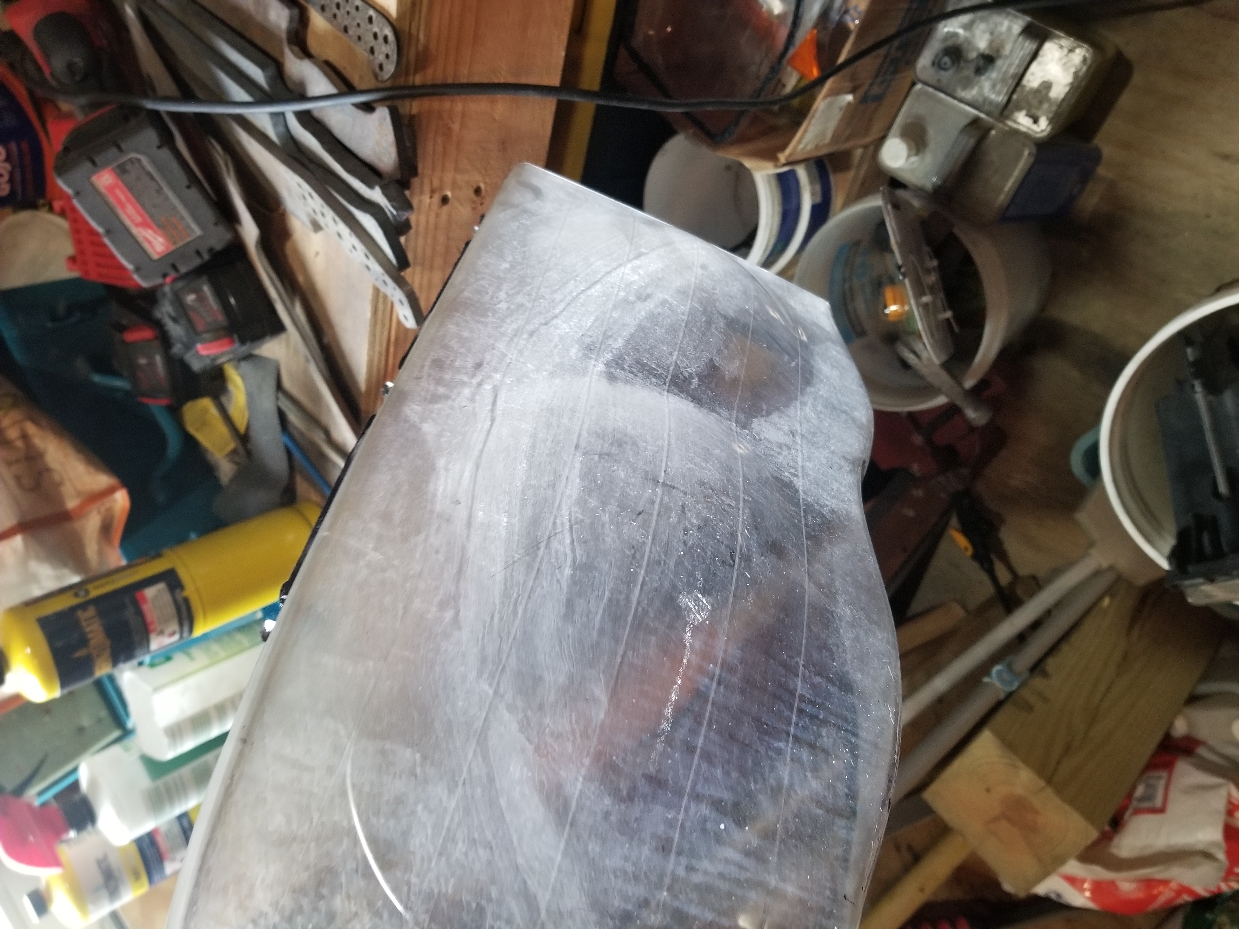

Headlight lenses got crazy cloudy....some sanding ...compound...buffing wheel...and clear coat of paint

The stuff lasted about 18 months for me.
I used this for sanding the headlights. Add a few drops of baby shampoo to your water when wet sanding. I used the clear coat that came with this kit on the motorhome. It was so~so. For the PW, I used what you used. Seem a bit better.
https://www.walmart.com/ip/Rain-X-Headl ... lsrc=aw.ds
