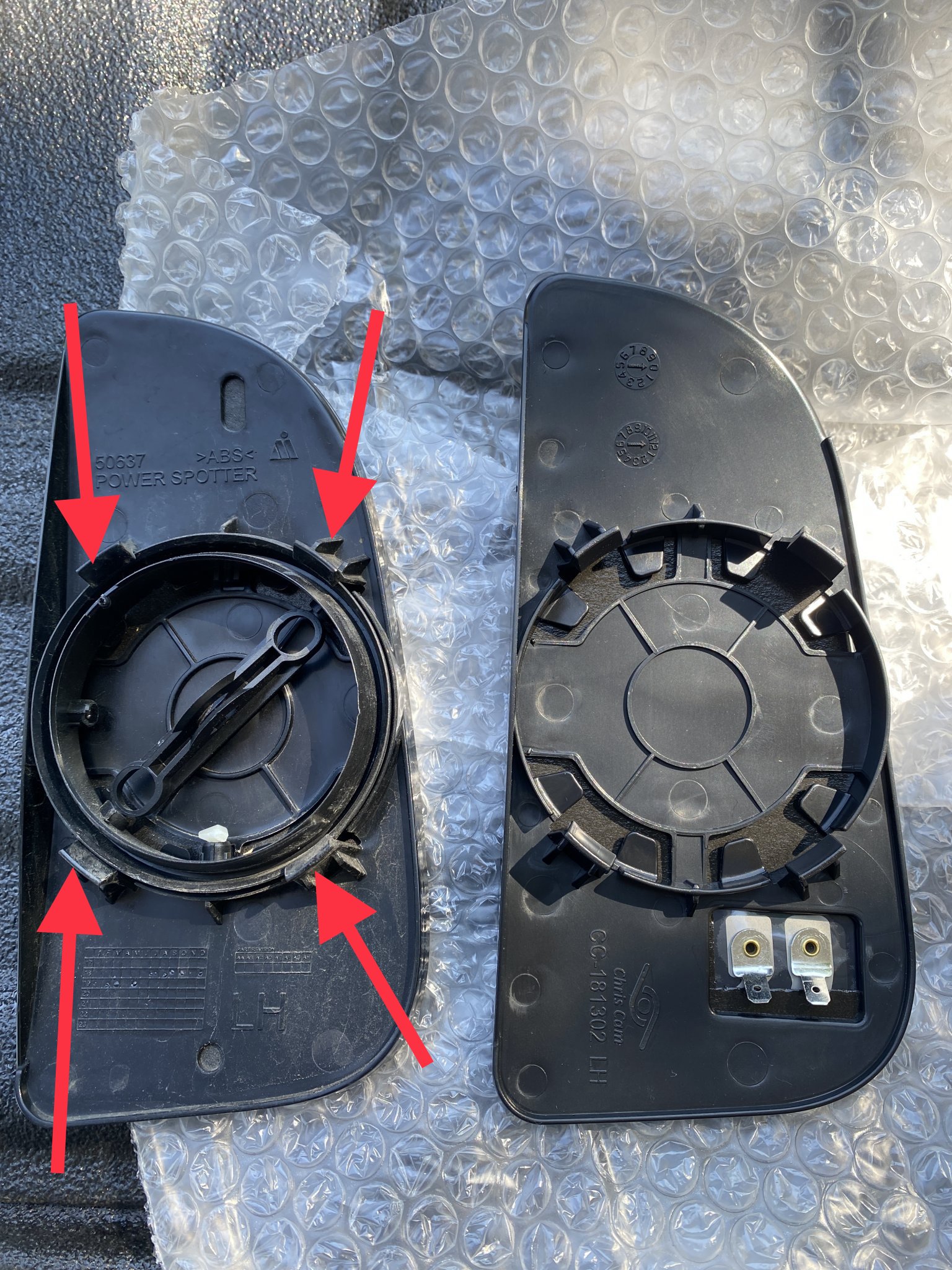

Important note: If you have a 4.5 Gen with power mirrors, the instructional video doesn’t say to release the side tabs on the convex mirrors, it just says to pry. I ended up breaking part of the motor, and that part is not sold separately (by Ram) so you would need to replace the whole mirror. Fortunately I found the motor assembly (for a different application) on eBay and was able to salvage parts to fix mine.

Where's the tab? They look amazing but I hate DIY projects that grow when I break something...

You have a 2016…so I assume they are manual adjust convex mirrors, so I don’t think you will have the delicate motor parts that I broke.
In the attached image you can see the oem mirror (left) with the part of the mirror motor that broke off when I removed it still attached. The arrows point to the red tabs that need to be released. Once the main glass is off you can release 2 or 3 of them with you fingers, then you can gently work to pry the mirror off.
Getting the main glass off is a little tricky/scary, but overall the job is easy. No wire cutting/splicing required. Worth the $80-ish bucks (or even the $150 it ended up costing me)

Wow, super easy on the fourth gen. Second one didn't take me more than 1-2 minutes. First had a bit of a learning curve but still was pretty easy just awkward working my fingers in behind the lens.. Thanks for sharing this! I am excited, I have been noticing in the mornings now that it's cooler I use the defrost every day and I really do lean on the outer convex to see blind spots while changing lanes.
