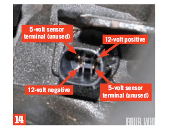

Try an Abel bypass to make sure it is actually the diff maybe? If it is toast would the housing accept a non-Power Wagon diff built with an Arb or Eaton or something?

Try searching for AAM #40047275. I have a test harness I can send you, just plug it into the locker and then connect it to any 12V battery to determine if the actuator or differential are actually faulty. PM me your mailing address and I'll mail it out. Just return it when you're done, so it's ready for the next guy.

Jack up your rear axle, spin your tires by hand, apply power and ground to your locker connector, try to spin the tires by hand again and you'll soon know whether or not your differential is bad.Bluchalk wrote: ↑Wed Sep 01, 2021 6:36 pmThe actuator is brand new. Second one. Tech who worked on seamed to at least sound like he knows what he’s talking about. It’s the second actuator I’ve had put in 3 years. He said he thinks differential was bad and he thought it is what cause the actuator’s fail both times.
