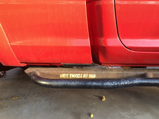

You don’t like the natural look? :lol:
5 years of nature looks like this:
