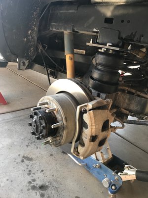

Install was pretty simple. Need 5.5 mm and 6 mm allen keys, 30 ft lb torque wrench, 9/16" combo wrench (preferably ratchetting). 3/8" ratchet with 16 mm, 9/16" and 5/8" sockets, wheel nut socket, 1/2" drive 21 mm socket and 21 mm wrench. 1/2" open end to install air fittings. 1/" pilot bit, 5/16" bit, 3/8" tap, tap handle. Wd-40. 1.5 ton or better floor jack, two HD jackstands. Sharpie
First step was to build out the airbags in the house where it was warm
Next was to take off wheel, bump stop, spacer and lower shock bolt. Drop the axle all the way down. finger tight install of airbag, line up the days star cradle. Mark with sharpie.
Strip off airbag and mount. Use 1/8" bit to drill pilot hole. Proceed to drill 5/16", thread hole. Install daystar cradle. Reinstall upper mount (torqueing allen head bolts for brackets to 30 ft lb).
Re-install shock bolt, put tire back on, repeat on other side. Remaining parts from not using lower mounts. Weight increase seems minimal as bumpstop spacers were quite heavy. Overall height seems perfect with no spacers.

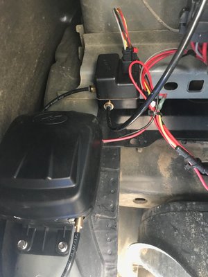

Installed the Wireless one compressor and remote solenoid today. I mounted it to the front of the bed support frame under the drivers side. There was a ground stud on the frame for the fuel filler so I connected the compressor and solenoid to that.
The solenoid is well above the frame rails and the compressor is about halfway up. I aimed it down as the larger vents appeared to be on the top.
Used the supplied fuse adapter to connect to the Fuse 90/91 (rear power point).
Teed in a line to the rear bumper with an air valve that can be used as back up if the compressor isn't working.
I did have to sync the remote to the control solenoid, not too hard just take the cap off the yellow wire and ground it while plugging the solenoid in.
Remote is super cool, one touch to go to your two settings (can add a third as well), I have 5 psi and 50 psi programmed in. Air compressor is adequate for this application (takes a couple of minutes to go from 5 to 50 psi.)
At 80 psi, the truck is noticeably tail high compared to stock, this is with no oem PW bumpstop spacers, just daystar cradles mounted directly to the axle.

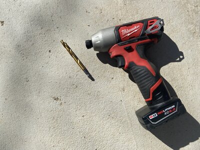

I finally got my 5000 Ultimate air bags and Daystar cradles installed. Life and procrastination have been getting in the way.
Everything was very straightforward. I really didn't want to mess with the lower shock bolts so I had planned on using a 90deg offset drill chuck that has sat unused in my toolbox for about 25 years. I removed the chuck from my old corded drill without issue and then realized there was no way put a 3/8" chuck on a drill that uses a 1/2" one.
The chucks would not budge from my 3/8" Dewalt or Milwaukee drills.
While I was looking at my collection of power tools, I realized my little 12v Milwaukee impact driver might be the solution. Sure enough, I found a 5/16" drill bit for impact drivers problem solved with room to spare. The only other deviation from the previous posts was my placement of the fill valves. I used the upper holes in my rear license plate. I stole the idea from pictures on line.

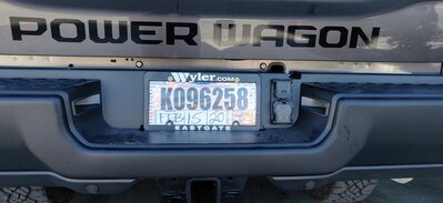

2018 Power Wagon

I like the fill valve location. I'm stealing that when I do mine.
