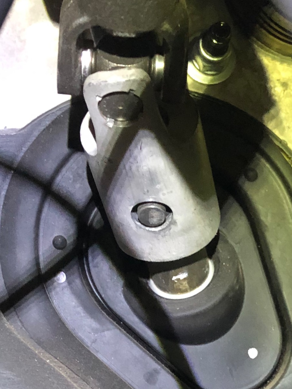

Have you looked at you upper intermediate steering shaft coupler? The rubber in the isolator fails and you will get slop and a click in the wheel that can also be felt in the brake/throttle as they are all part of the same sub-assembly attached to the firewall. EMF has a press in bushing fix that I did in-place without removing the upper shaft.
The lower intermediate shaft u-joint might also be worn.
I know that lower joint on mine is going bad or I have excessive slop developing in the steering box at 75k... (I just haven't taken the time to figure out which it is, I don't think it is the Thuren track (check torque spec) bar, nor the balljoints.

already have the emf bushing fix completed.Oilbrnr wrote: ↑Fri Sep 04, 2020 4:59 pmHave you looked at you upper intermediate steering shaft coupler? The rubber in the isolator fails and you will get slop and a click in the wheel that can also be felt in the brake/throttle as they are all part of the same sub-assembly attached to the firewall. EMF has a press in bushing fix that I did in-place without removing the upper shaft.
Im still confident this is occuring from the axles shifting, not so much from the steering input itself.
off camber road crown shifts(regrading/repaving highway) with no steering input will still thrust a pop sound from the trackbar (i think)

Ok on the bushing then.PWJouster wrote: ↑Tue Sep 08, 2020 11:05 am
I feel it most in a gentle left sweeper at 50+. I can feel it in the wheel clicking at it goes back and forth. Wonder if it would be visible (or audible) with a well placed GoPro...
