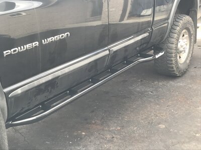

Installed my Maple Offroad sliders today, and I have a few initial thoughts to share. First, the shipping was top notch. Unbelievably well packed. Two thumbs way up for that. Once they were uncrated, it was easily apparent to me and the three guys helping me unload them, that they are extremely heavily built. Getting on to the install---you NEED two people and some jack stands for the install. They passenger side is pretty easy, but the drivers side is a bit of a bear because of the fuel tank and the e brake wire. Patience is a virtue--lol. I did have to hog out a couple of holes on the mounting brackets in order to get them to fit. (There seemed to be a combination of factors at play for this---many years of Krown buildup, and a bit of a raised edge on each frame rail on the third mounting point back that I could not move the rail fore or aft to clear. Not a manufacturing issue in my opinion--- sometime I have seen frames will a little extra meat on them in different spots. No big deal--10 minutes on a drill press with a cutting bit and all was good). All in all everything went about expected. It took 2 guys about 3 hours start to finish with a 15 minute break for a couple beers and a sammich halfway through. The test drive went perfectly with no squeaks or rattles! Overall very impressed!
P.S sorry for the pics showing the truck so dirty---but that is it's natural state.

Lol. I put mine on all by my lonesome. With some careful balancing on my 3 ton floor jack. I did feel quite beat up afterwards though. I had to take a grinder to the top of 2 front mounting " flanges" and 4 front inner mounting plates. I had contact with the floor tub. I think all the gens and different years might have some frame and body variances, so I felt the same way that it isn't a defect. If you're capable of installing these you should be mechanically inclined enough to modify them a bit....right? I've heard of people having clearance issues with WKO sliders as well. I can tell you first hand they can take a beating. I landed extremely hard on the right side at a gatekeeper at Rausch Creek. Expect that the decals will be scuffed off as well. I used the kick outs to pivot around some boulders. Neil uses tricorn black” and it’s a Sherin Williams color number sw6258. Buy a can of that and a small roller for touch ups. I also got the skid plate which is very stout as well.Image

I am seriously impressed that you did it all by yourself! We had 2 floor jacks and were both under the truck on creepers pushing and pulling them into place for the bolts to line up. Now that you mention it, I did grind a bit off the top of one of the backing plates---it did clear, but it was tight to the floor pan; and I didn't want it to squeak. Again---props to you for getting it done yourself---you sir are a better man than me!
