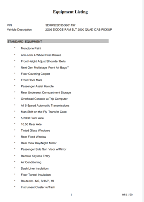

Need help. What does my PW have?
Just bought my 2005 PW this weekend and it came with nothing. No owners manual, no winch remote, no spare (no biggie), no key fob (s) or any idea if it came with one...and I basically have no idea what options it came with. My VIN is 3D7KS28D35G901197.
It's got some stuff wrong with it, luckily most items are addressed in this forum I've been engulfed in since I came aboard. ANY help you can give me would be very helpful. I have no idea if anything has been modded/replaced/upgraded. So I'm pretty lost.
Thank you in advance for your help.

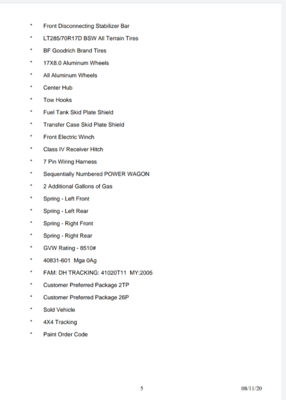

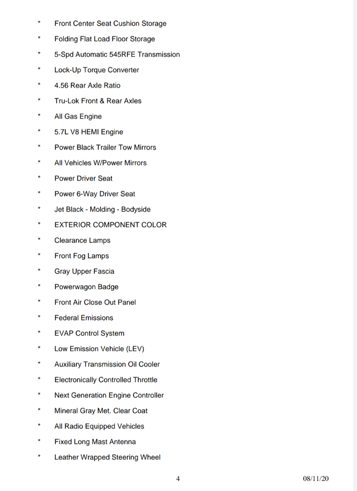

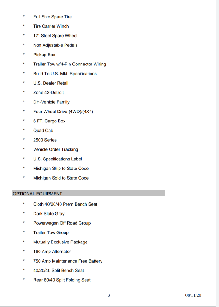

https://www.ramtrucks.com/webselfservice/BuildSheetServlet?vin=3D7KS28D35G901197
Re: Need help. What does my PW have?
That's weird it gave you an error. I was able to pull it up. And I'd wish I'd have waited before spending 5 bucks for the same thing.
Thanks for the information!!
