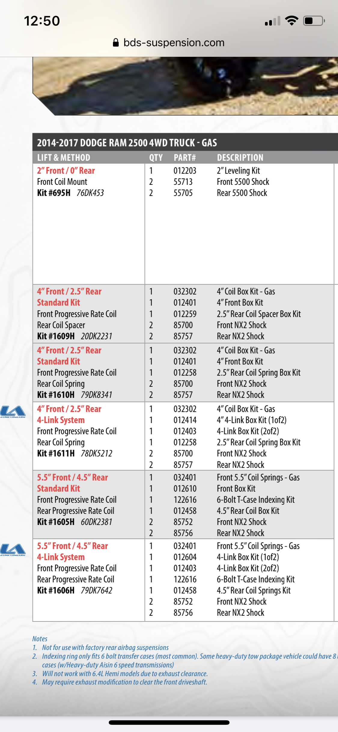

Anybody use them? Are they 4" over a stock 2500 or 4" over a PW?

They are 4” over a pw. Im sure they are just the normal 2500 6” coils.

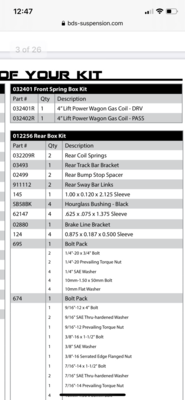

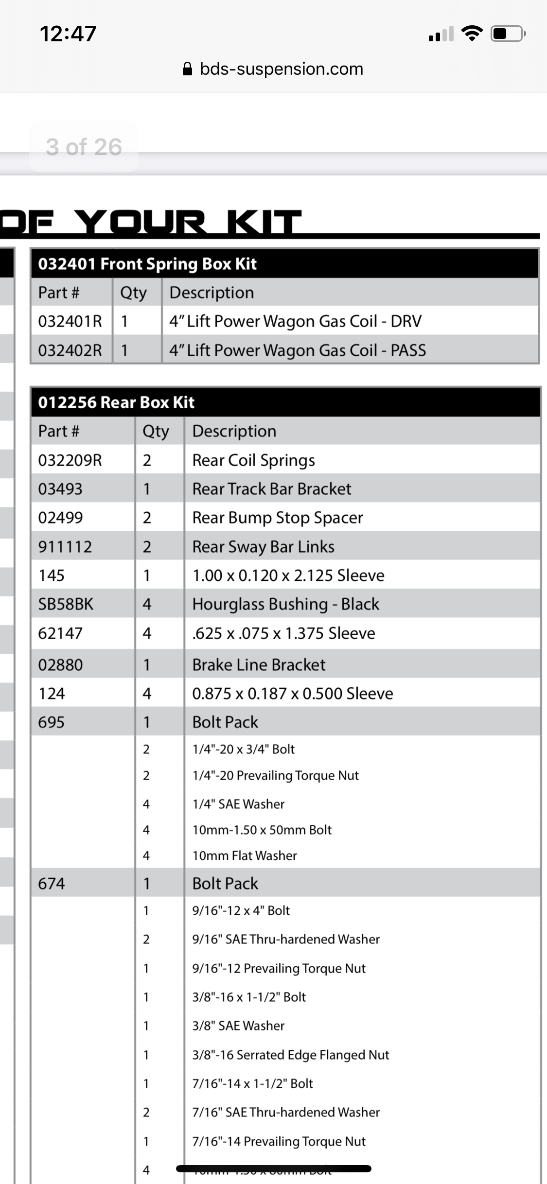

Post by olyelr » Thu Feb 27, 2020 12:54 pm
According to the part numbers listed on the bds website, the front coils for the pw lift have the same part number as the front coils for the 5.5” normal 2500 gas and 4” 2500 diesel.
So there we have it.
