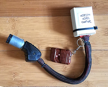

verdesardog
Posts: 989
Re: HF Wireless remote ?
Post by verdesardog » Fri Dec 27, 2019 12:03 pm
FirerescuePW wrote:
Mon Mar 28, 2016 6:47 am
I think VerdeSARdog has one, or one similar, on his hydraulic winch. Hopefully he jumps in to verify.
Old thread, I know!
Yep my cheap wireless is still working great!
The unlock button is power out, the lock button is winch in:
