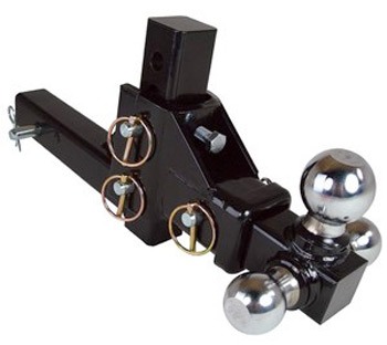

Anyone had any experience with this product? I like the idea of one and done.

Might be handy but also how often you need anything but 2" ball. If you do than sure. If you own a trailer than get appropriate drop hitch and be done. Little point for lugging around extras you will never need. Adds more rattles and something to catch the ground.

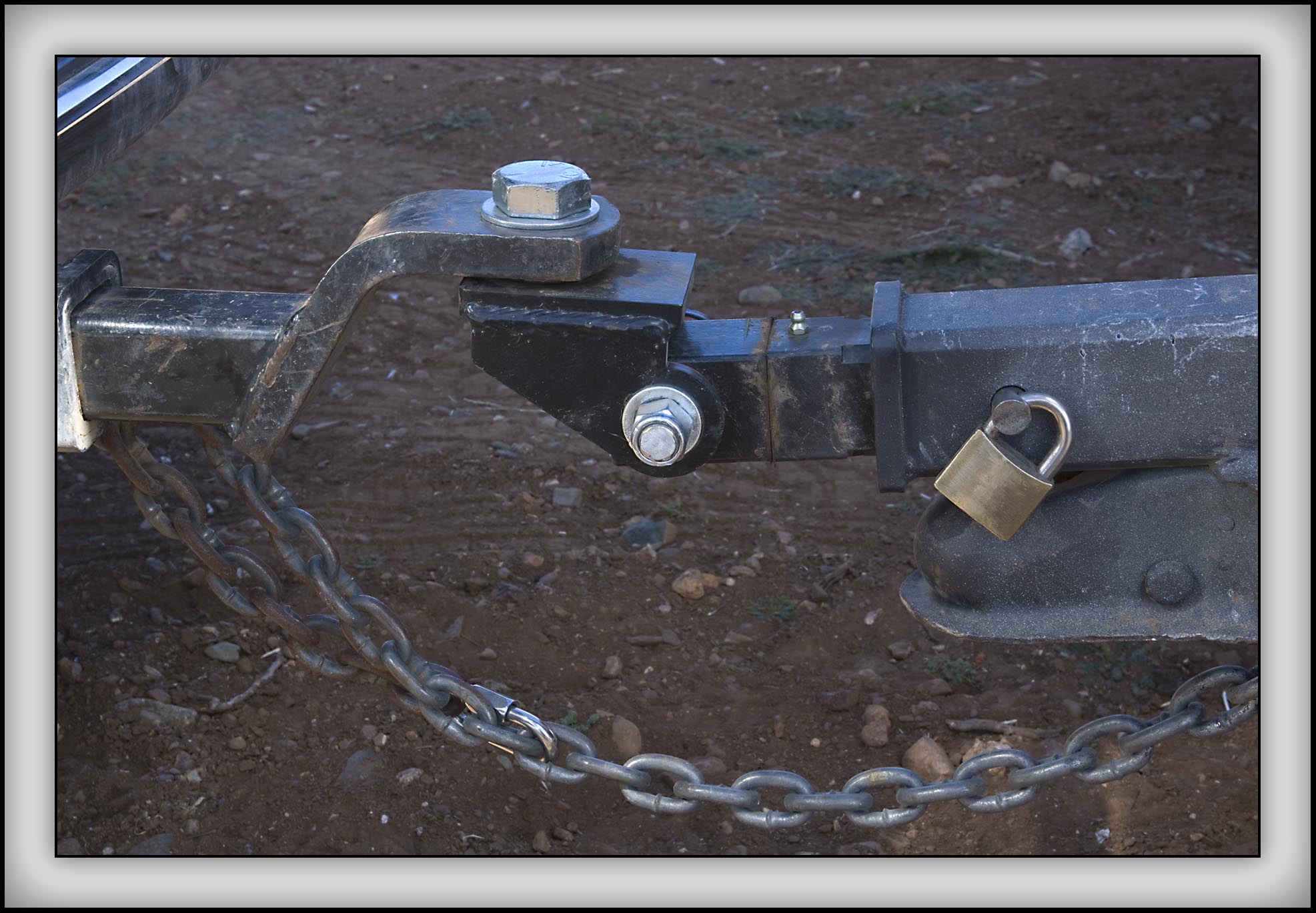

Here's what I run. Trimax Razor with Reese interchangeable balls. I rarely use 1 7/8" or 2 5/16" but I have them when needed. It's also much cheaper than some of the billet alternatives. Hitch is about $100 and balls were about $30.

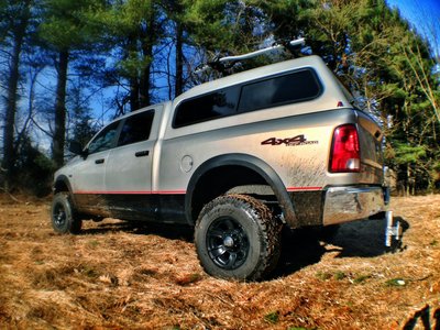

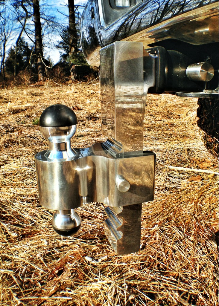

I have the Rapid Hitch 10" for my truck

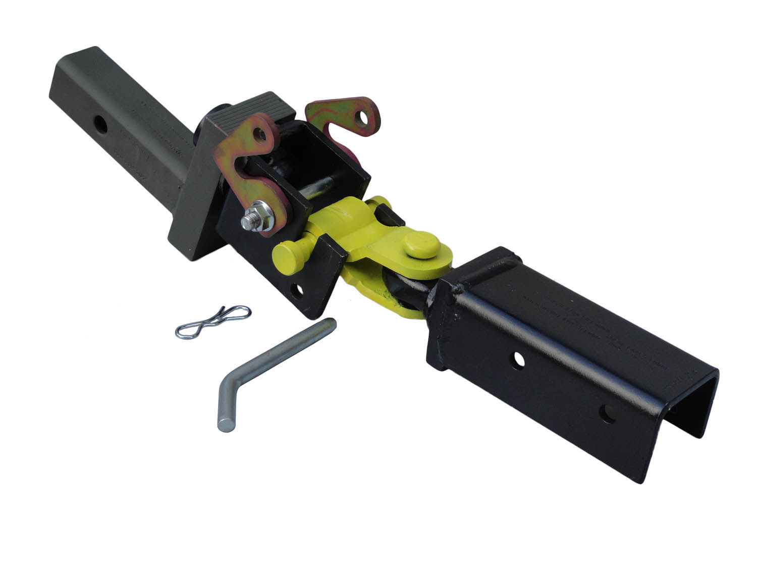

Here's what I'm going to get for the camping trailer I'm building:
As much articulation as a pintle hitch without all the clanging and banging.

04Ram2500Hemi wrote:I have the Rapid Hitch 10" for my truck
http://www.andersenhitches.com/Catalog/ ... hitch.aspx
I like this one a lot. Which did you get? The greaseless or the original?

Last question, do you guys find that you really need the 10" or would the 6" work ok? My PW has not been lifted. I'm going to order one today just not sure which size or whether to go with the greaseless ball or not. Decisions, decisions.......

tat6272 wrote:Last question, do you guys find that you really need the 10" or would the 6" work ok? My PW has not been lifted. I'm going to order one today just not sure which size .
Although there is NO standard, MOST trailer couplers are about 18" from the ground to top of ball.

This was helpful. Thanks. I went with the 10 inch greaseless.

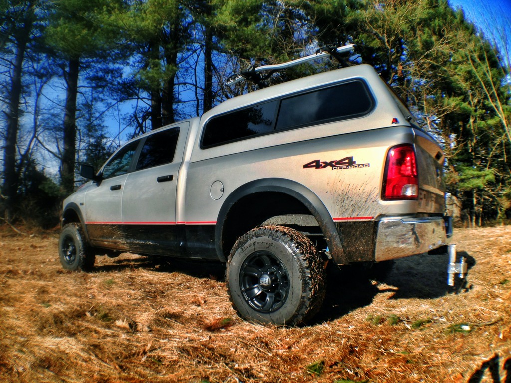

Got the Andersen Rapid Hitch 10" with greaseless balls. This hitch is a thing if beauty. Solid aluminum (yes, aluminum, but it's heavy as hell). Probably should have gone with the 6" though. 10" is probably better for a lifted truck.

tat6272 wrote:Got the Andersen Rapid Hitch 10" with greaseless balls. This hitch is a thing if beauty. Solid aluminum (yes, aluminum, but it's heavy as hell). Probably should have gone with the 6" though. 10" is probably better for a lifted truck.
You're not kidding- the 10" is heavy. However, I never want to have to buy another hitch again, so that's why I went with the big one.

I didn't get the hitch I orginally posted I got this one:
No ball! Can't pop off unless something breaks......
