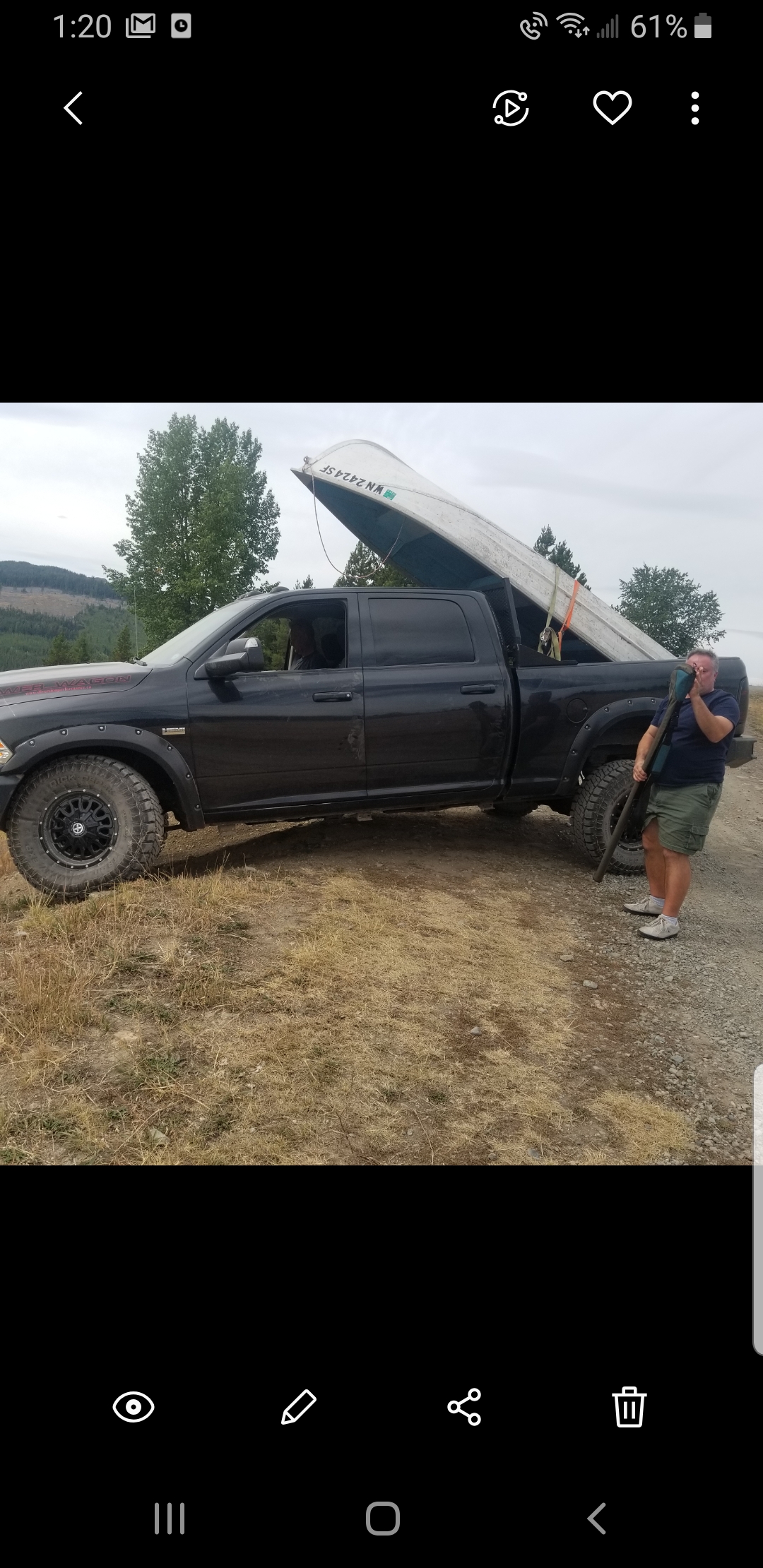

I was heading to my favourite fishing lake on the wknd and truck was flexing nicely when I heard a pop. Looked around and looked like it was judt the tire rubbing in wheel well. Kept driving and hit the trail to the lake.
I then looked around truck and the sway bar in one side snapped in half, not the end link but actual bar, how is this possible. I had to tow my trailer home next day, 3 hrs,but truck drove fine.
I thought I could weld it and put a sleeve around then weld that but my Dodge mechanic buddy says it is spring steel and it will just break. Any ideas. Thought I could just buy the one bar, drivers side, that goes into motor but local dodge dealer says the sway bar is discontinued, wtf

It was connected, in 4 low, going slow about to go down the hill in pic. This is where it happened. Going to stop at a machine shop tomorrow and see if they csn do anything. Didn't really notice it towing and I was driving through a windy highway, guess the one side connected helps. Didn't think these things were made in China....
