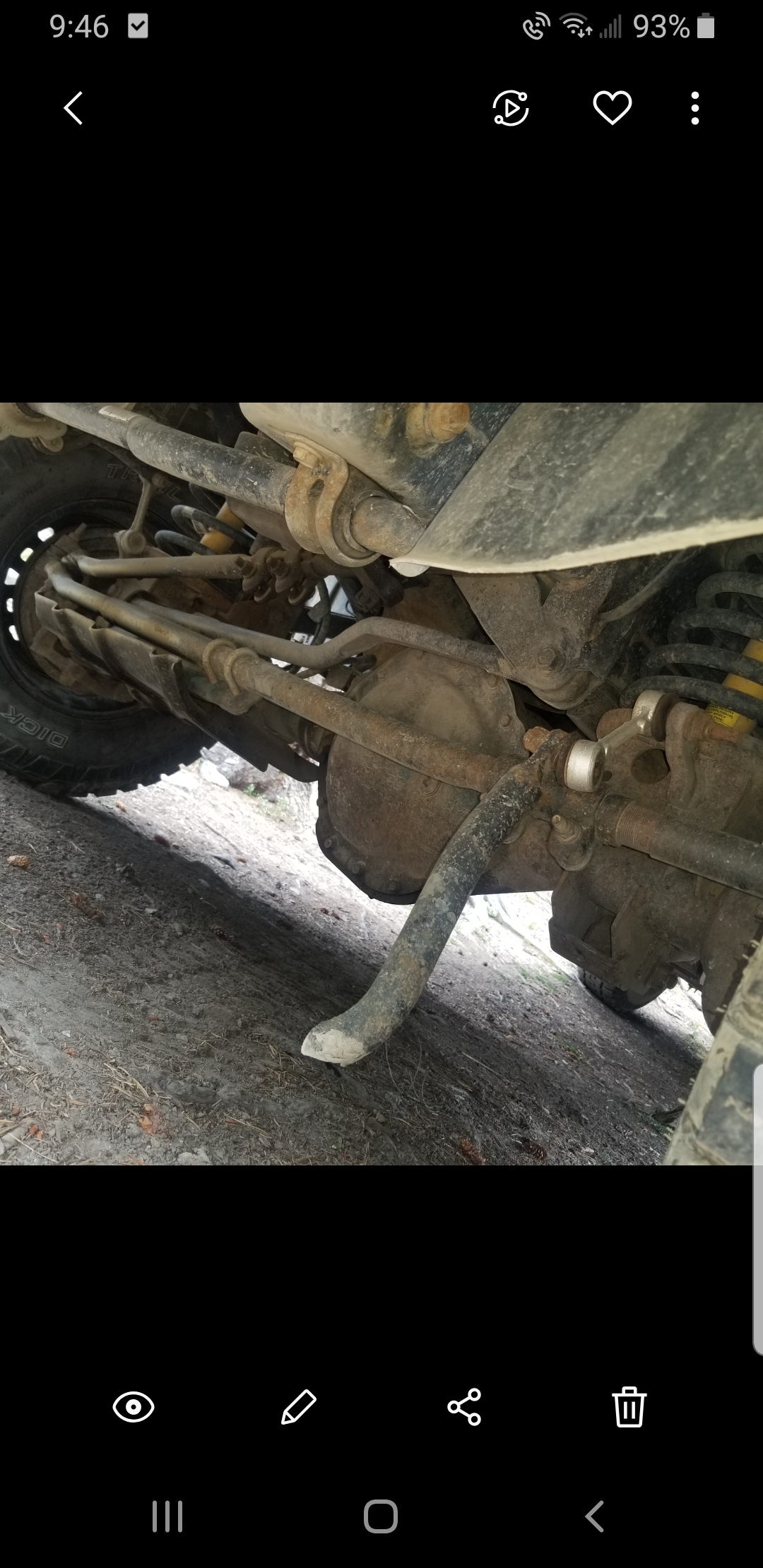

I was heading to my favourite fishing lake on the wknd and truck was flexing nicely when I heard a pop. Looked around and looked like it was judt the tire rubbing in wheel well. Kept driving and hit the trail to the lake.
I then looked around truck and the sway bar in one side snapped in half, not the end link but actual bar, how is this possible. I had to tow my trailer home next day, 3 hrs,but truck drove fine.
I thought I could weld it and put a sleeve around then weld that but my Dodge mechanic buddy says it is spring steel and it will just break. Any ideas. Thought I could just buy the one bar, drivers side, that goes into motor but local dodge dealer says the sway bar is discontinued, wtf

did you have the swaybar disconnected?
were you in 4WD?
how fast?
were you in 4WD?
how fast?

It must have been CONNECTED - there wouldn't be any stress on it in a disconnected state.

It was connected, in 4 low, going slow about to go down the hill in pic. This is where it happened. Going to stop at a machine shop tomorrow and see if they csn do anything. Didn't really notice it towing and I was driving through a windy highway, guess the one side connected helps. Didn't think these things were made in China....

$950 is a steal. New lists for $2,700. I got a new smart bar for $1,800.
Go to the dealer and get the part number for your smart bar. Use that number in the link below.

I would clamp the smart bar module out of the way and get a Thuren sway bar. It would be $520 for your truck:

I found a used bar but it's off a 07. Anyone know of any differences? Mine is 2011

You have the 5 link front suspension like the 3G's. I bet it will bolt up. BUT the electronics might be different. You can swap out the actuators from one bar to another. It's only 3 bolts.
Re: New Sway bar disconnect.....
If you can't make the electronics work you can go with a manual disconnect for it to make it work too.
