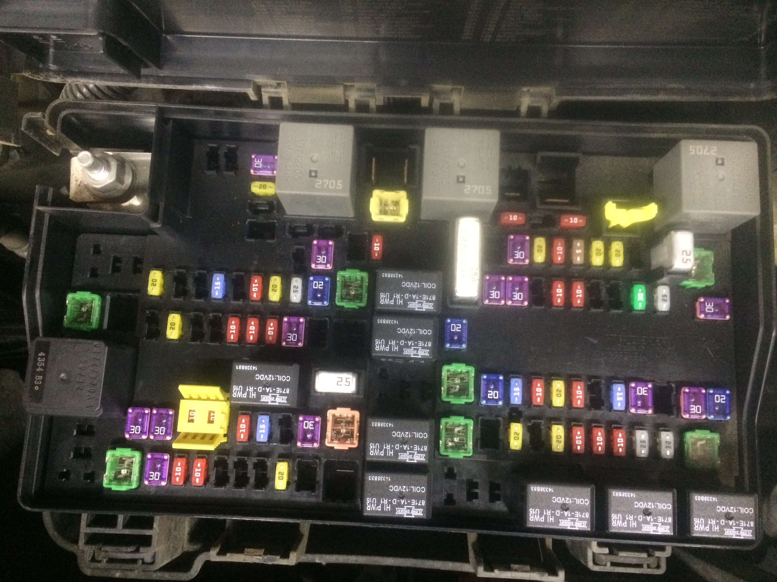

I think the fusebox is the same between a 1500 and 2500, if your fusebox looks like this...Will wrote: ↑Tue May 21, 2019 4:48 pmThis new 2019 1500 is ridiculously nanny controlled. Can NOT power out of a mud hole, it'll kill the gas and abs kicks in, all kinds of crazy shit. Turn it all off and it must come back on at 15mph or something because as soon as you think something good is going to happen, nope.
Then the Nanny Kill Switch should work in your truck.
Re: Traction control on 2011?
Well kiss my ass, I'll definitely look and if it will, go ahead and send me one.Retired BLM Rig wrote: ↑Tue May 21, 2019 9:44 pmI think the fusebox is the same between a 1500 and 2500, if your fusebox looks like this...Will wrote: ↑Tue May 21, 2019 4:48 pmThis new 2019 1500 is ridiculously nanny controlled. Can NOT power out of a mud hole, it'll kill the gas and abs kicks in, all kinds of crazy shit. Turn it all off and it must come back on at 15mph or something because as soon as you think something good is going to happen, nope.
