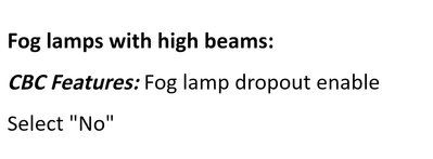

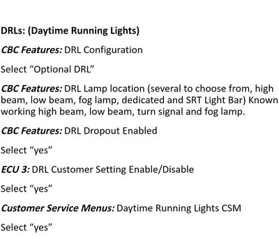

Foglights on during highbeams and added as DRLs successfull, playing with the tipms threshholds next. The issues I had with the original AlfaOBD forums were digging through the hundreds of posts. A shoutout to continuecrushing on taking time out to get this going, and making it barney style for us.
Note: My 2013, does not show DRLs on the CSM and seemed to activate both DRLs and fogs with highbeams immediately.
