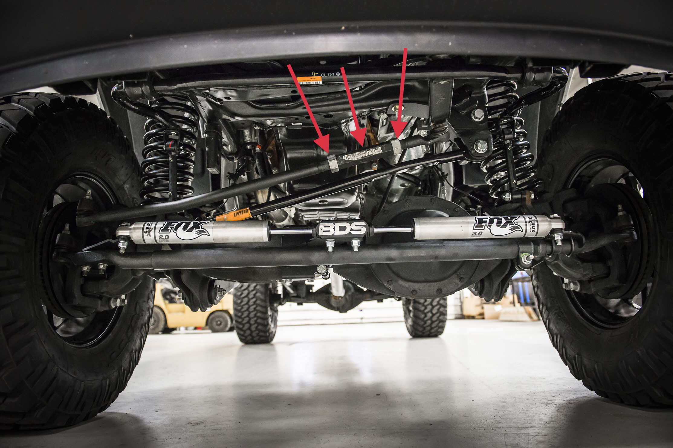

Its the two nuts on eack side of the adjuster sleeve on the drag link.
Re: 2013+ truck steering nut recall?
Post by olyelr » Thu Feb 14, 2019 6:54 am
I pulled this pic off the net and added arrows to the two nuts and adjuster sleeve.

The drag link, I see. Confident that picture is of the offending nut(s)?
