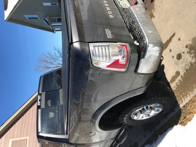

Post by ramv » Sat Jan 19, 2019 7:08 pm
Fixed! New tail light and I massaged the dent out mainly. Just need to touch up the scratch.

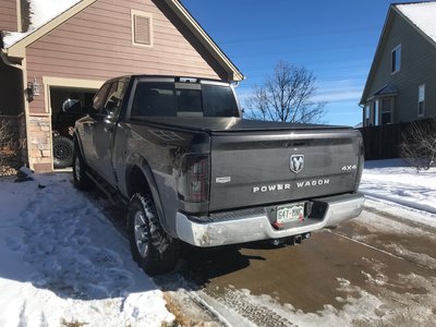

Post by olyelr » Sun Jan 20, 2019 1:01 pm
Hey, whats the deal with the salta wheel and toyo tire in the garage :mrgreen:

Post by ramv » Sun Jan 20, 2019 5:39 pm
There's three more. Ready for Summer! (The BFG's have the snow flake rating, so more options for Colorado chain laws) Toyo's will be the summer tire!

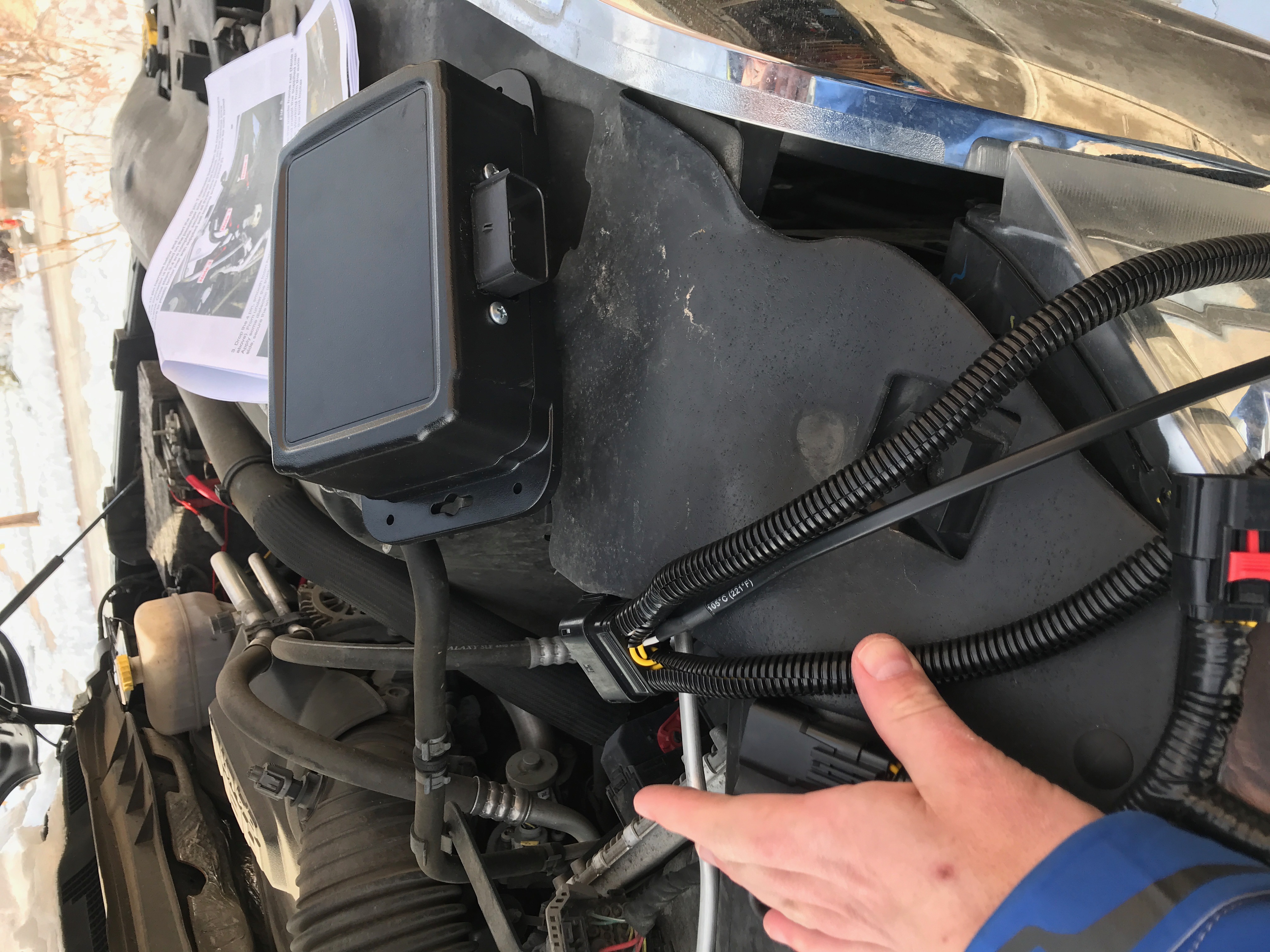

Post by Idaho RC » Sat Jan 26, 2019 7:30 pm
I am working on installing the kit on my 2017. To mount the control box the air box and the air box mount to the inner fender needs to be removed.
How do you get the air box assembly out of the way to mount the control box to the fender? I can see the top two bolts but I can’t see how you remove the bolts on the bottom.
Any help would be greatly appreciated.
