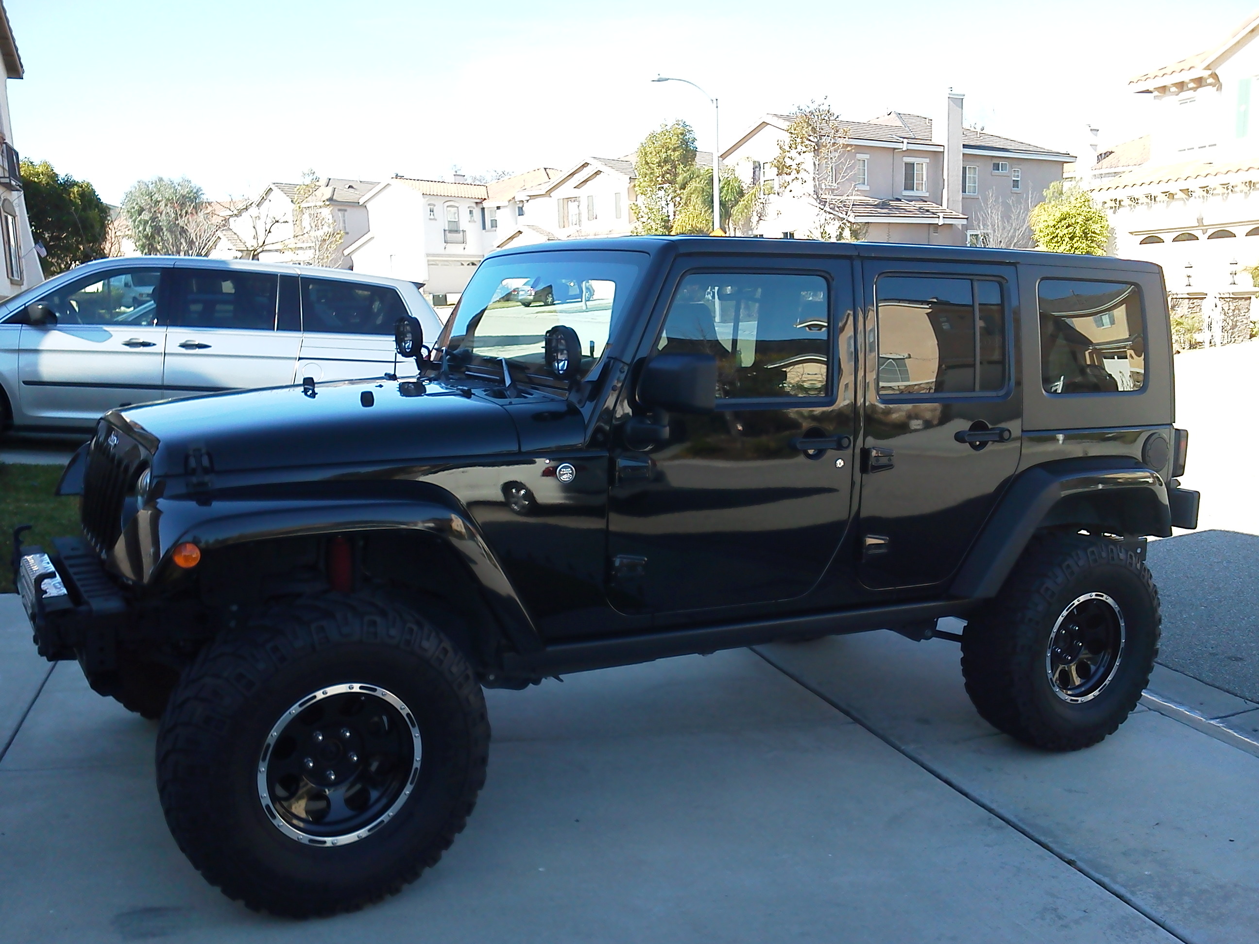

BDS 6 inch long arm/ fox socks (non reservor) / 35 Nitto Mud Terrain....This truck rides so nice...very smooth on the highway. Most of the off road driving I do is Desert Roads or sand dunes.....I dont go to crazy since I dont want to scare the shit out of my wife and young kids....but for what we do it is absolutely awsome. We drive some long distances to the eastern sierra's and it is like a car smooth....I can get up to 12 MPH at 65 mph.....on those trips. The best I ever got was 13.8 mpg , but as soon as I go 70 it drops to 9 mpg.....Its been a great toy, I have had many jeeps prior to this and actually miss the wrangler JK very much, but I cant beat the Power Wagen for comfort ,interior space, and over all capability , tow, and still run the jeep trails and sand dunes we like to do......
