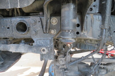

Post by RustyPW » Sun Jun 04, 2023 1:09 am

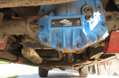

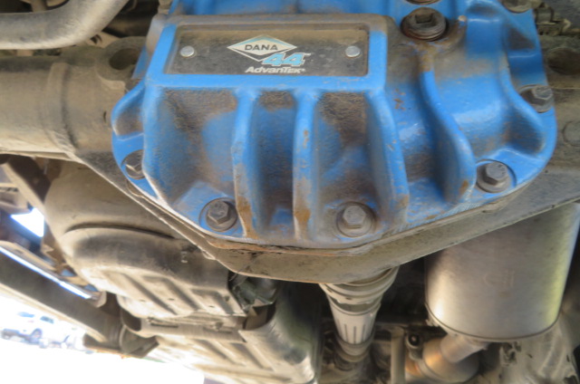

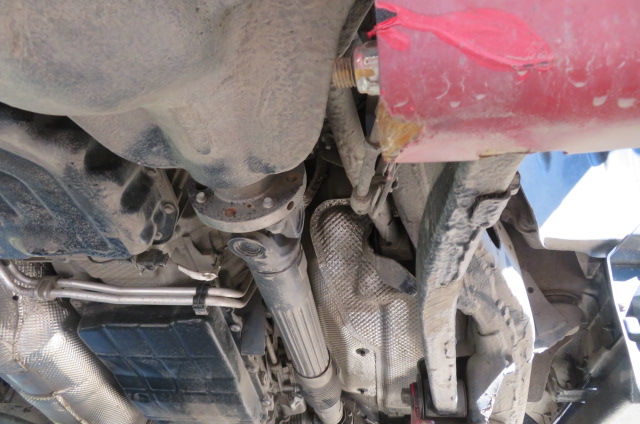

little trail damage from Rausch Creek.
The Diff covers

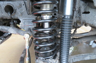

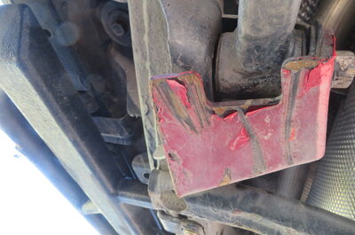

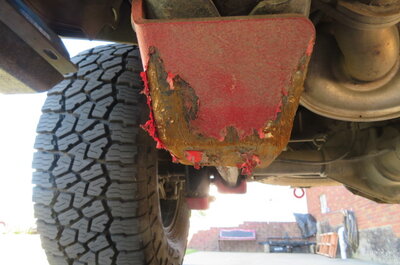

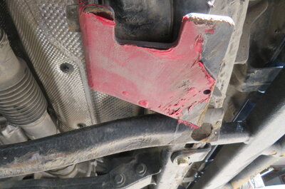

Post by RustyPW » Sun Jun 04, 2023 1:12 am

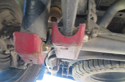

The suspension skid plates got kissed.

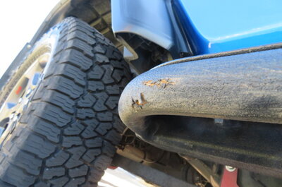

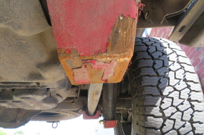

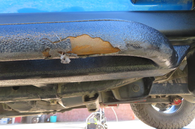

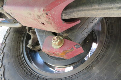

Post by RustyPW » Sun Jun 04, 2023 1:15 am

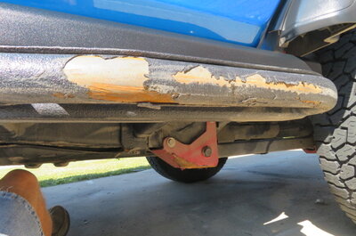

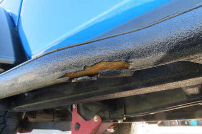

The White Knuckle sliders did their job. They got landed on from a 3ft drop. The Line-x coating got peeled off in a few spots.

SimonandSimonBeast wrote:
Sun Jun 04, 2023 6:28 am
Gee, you hardly got anything done. I thought you would be further along now....lol.
I'm a lot farther along then you think. :lol:
Posts: 5485
Re: Rusty's Build 2022 Gladiator Rubi Diesel
Post by RustyPW » Sun Jun 04, 2023 12:01 pm
Mule007 wrote:
Sun Jun 04, 2023 9:52 am
:rockon: nice pics on your build 👍 Rusty, you have been busy! It’s looking good! Would you linex the rock rails again? Your thoughts on the diesel,,,front end weight? Torque on driveline components?
If I didn't off road. The LineX on the rails would be good. Thinking now. I would have been better off using spray on bed liner from a rattle can. It would be easier touch up. That's what I'm using now for touch up.

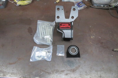

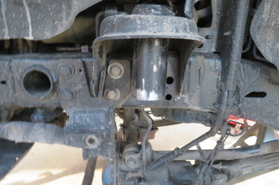

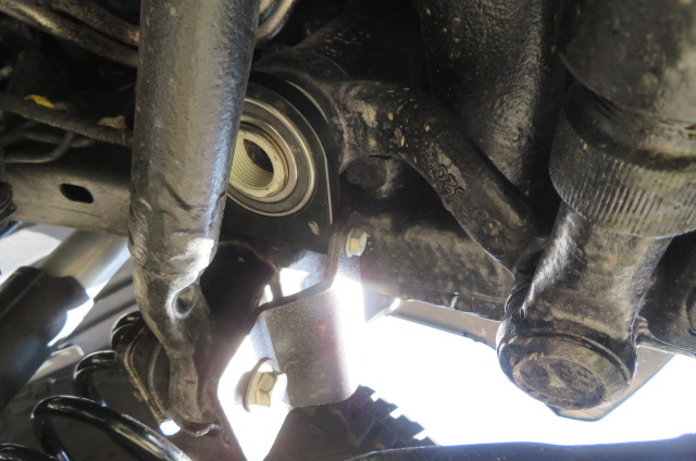

Added a Steer Smart steering box/ track bar brace.

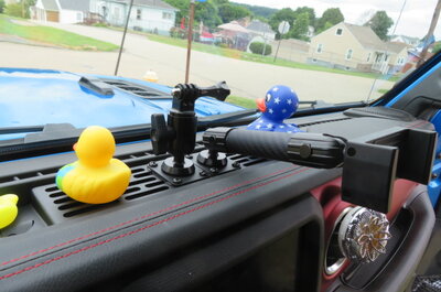

Have the Bullet Point dash attachment installed.

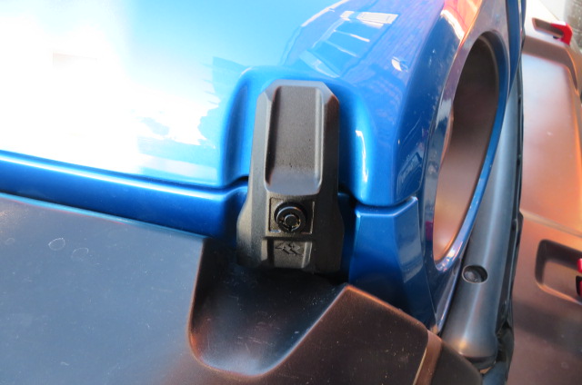

Installed the rugged Ridge Locking hood Latches.

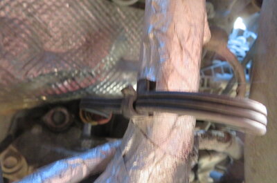

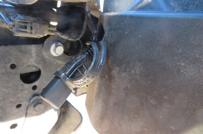

Post by RustyPW » Sat Jun 10, 2023 10:12 pm
Installed a block heater. The 2021 3L diesels came with the heater already installed. The 2022's and up do not.

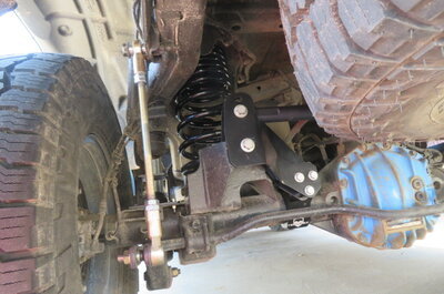

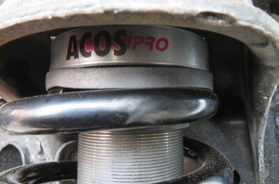

Installed a Frankenstein lift kit. Parts from different companies. Here's a list.
1. JKS Front Adjustable Coil Spring Spacer with Hydraulic Bump Stop. ACOS Pro. This will raise the front 2" by it's self.
2. Clayton 2.5" Diesel Springs in the front and Clayton 3.5" spring in the rear.
3. Core 4x4 Crawl Front Track Bar.
4. Core 4x4 Crawl Front Lower Control Arms.
5. Clayton Rear Track Bar with the bend for a 37" spare.
6. Clayton Sway Bar End Links.
7. Bilstein 5100 Shocks.
8.Teraflex Rear Upper Control Arm Extended Travel Brackets.
9. Teraflex Rear Spring Retainer.
10.Teraflex Rear Track Bar Bracket.
11.Teraflex Geo Bracket.
12.Teraflex Geo Bracket Reinforcement Kit.

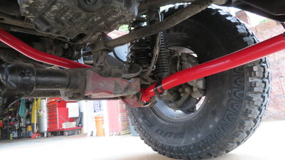

Posts: 5485
Post by RustyPW » Sat Jun 10, 2023 10:26 pm
Pictures

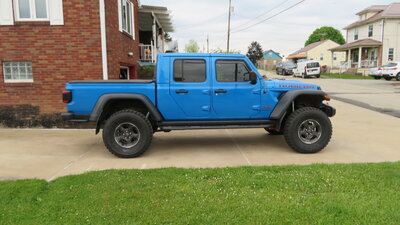

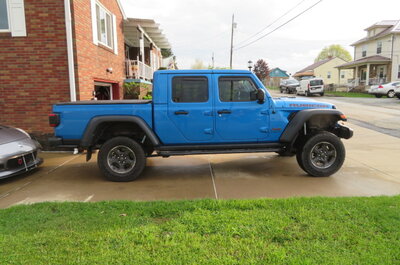

Posts: 5485
Post by RustyPW » Sat Jun 10, 2023 10:45 pm

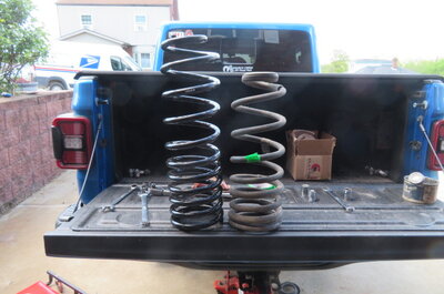

Before picture. Picture with the 2.5" rear springs and with the 3.5" rear springs with 37"tires. I originally wanted a 2.5" lift. So I got the Clayton 2.5" springs for front and rear. I didn't know that the JKS adjustable spring spacer would add 2" of lift by it's self. So I ended up with 4" lift in the front and 2.5" in the rear. The JKs sleeve is tack welded in place, so that wasn't coming off. So I decided to get the Clayton 3.5' rear springs. That leveled out to Jeep.
Posts: 5485
Post by RustyPW » Sat Jun 10, 2023 10:50 pm
The 37" tires I got from Walmart. Eldorado Mud Claws. They are made by Cooper tires here in the US. Got them for $276 each. To use them with the Rubi rims. i had to use 1.75" wheel spacers from Teraflex.
