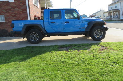

So...here's the JTRD
Ordered on 1/18/22.
1/29/22. E-mailed with VIN number and delivery date of 3/8/22.
2/2/22 Moved to D1. Build date 2/14/22.
2/16/22 Window sticker. Delivery date of 3/1/22.
2/28/22 Picked up from dealer.

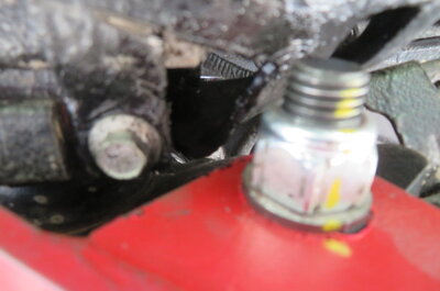

Had a problem on 3/3/22 that I know is a known issue. The fuses in the fuse box not being fully seated. 295 miles on the clock. Driving down a back country road. Hit a bump and the WHOLE dash goes black. Engine still running. Go about 200 yards and hit another bump and the dash comes back on. Get home, open the hood and check the fuses. Everyone was just sitting in their slots. Took a screwdriver and pushed everyone down.

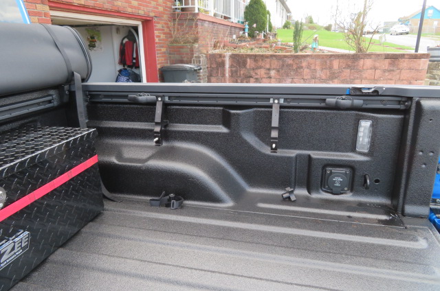

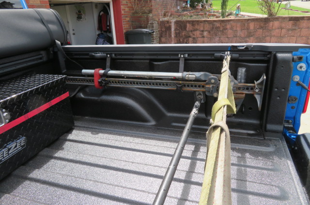

Have my Hi-Lift jack mounted in bed. Got the mounts from Northridge. Also got a 39" long, 12" wide, and 12" high tool box to hold my recovery gear.

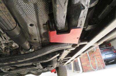

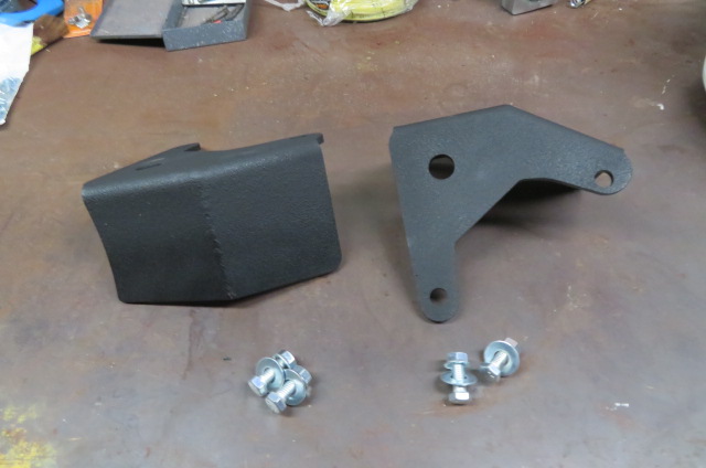

My Rusty's Offroad skid plates for the rear lower control arm frame mount came in. They're beefy. 1/4" thick. They come bare, so I sprayed them with spray bedliner. Makes it easier to touch up.

My Rock Hard skid plates for the lower control arms and rear lower shock mounts came in. I need some good weather to install all of this stuff.
1st and 2nd pic's are the front lower control arm skid plates. The 3rd pic's are the rear control arm and shock skid plates.

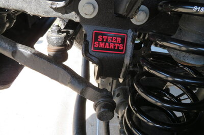

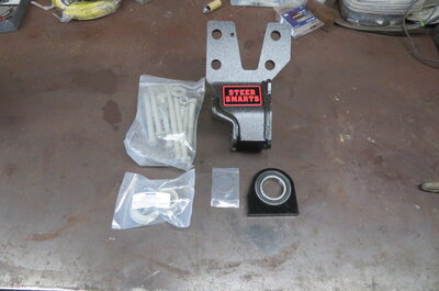

My Steer Smarts steering bracket came in today from Northridge. Got it installed. The wire they talk about in the video's that has to be relocated. I didn't have that.

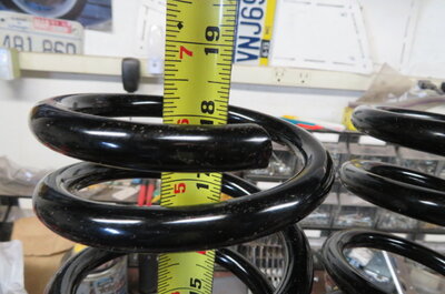

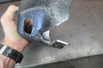

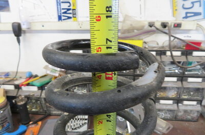

Was a Beta tester for Clayton front springs.

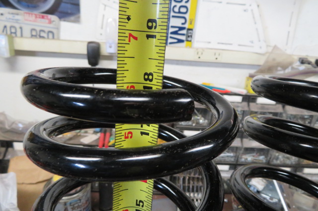

Got the proto Clayton springs installed today too. The stock spring measure 17" tall. The Clayton's measure 18" tall. Both have the same number of coils at 9. The wire diameter for the stock spring is 0.593. For the Clayton's is 0.553. The Clayton springs raised the front by about an inch. The JT sits almost level. The ride is stiffer. It doesn't float.
In the 3rd picture. The big spring is a stock 3G Power Wagon spring.
The 4th picture is what the '22 bump stop looks like.

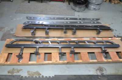

The White Knuckle sliders came. They are BEEFY. About 80lbs a side. Now to get them Line-Xed.

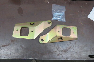

Finally got the Metalcloak rear sway bay supports.

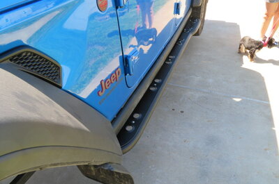

Got my White knuckle sliders back from being Line-Xed. Now have to wait for the monsoon season to quit to install them.

The White Knuckle sliders are on. These things are beefy, and heavy. Took a while to put them on.

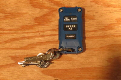

Got my AJT Design Key Fob today. Bit of a pita to do. I made a label with Jeep on it to put on the back side of it.

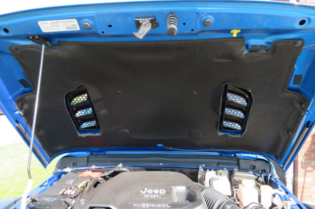

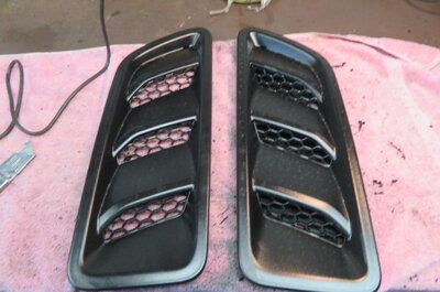

Today, I opened up the hood vents. Took all of 30 minutes. Used a 4" cut-off wheel on a die grinder and a small air powered belt sander. Still have to get a roll of silver HVAC tape to seal out the edges of the underhood insulation.

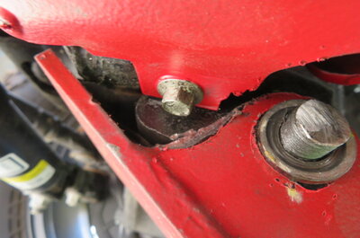

Got the Rock Hard front control arm rear mount skid plates on. Real easy. Remove the nut on the inside. Install the skid plate and nut. Torque to 190 ftlbs. I painted them red too.

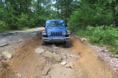

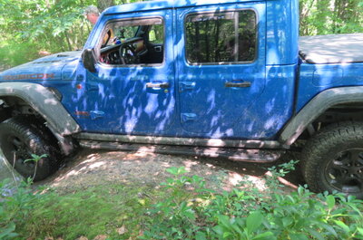

Couple of pic's from Rausch Creek.
Nothing like being a turtle. High centered. Got stuck 3 times that day. High centered each time.
