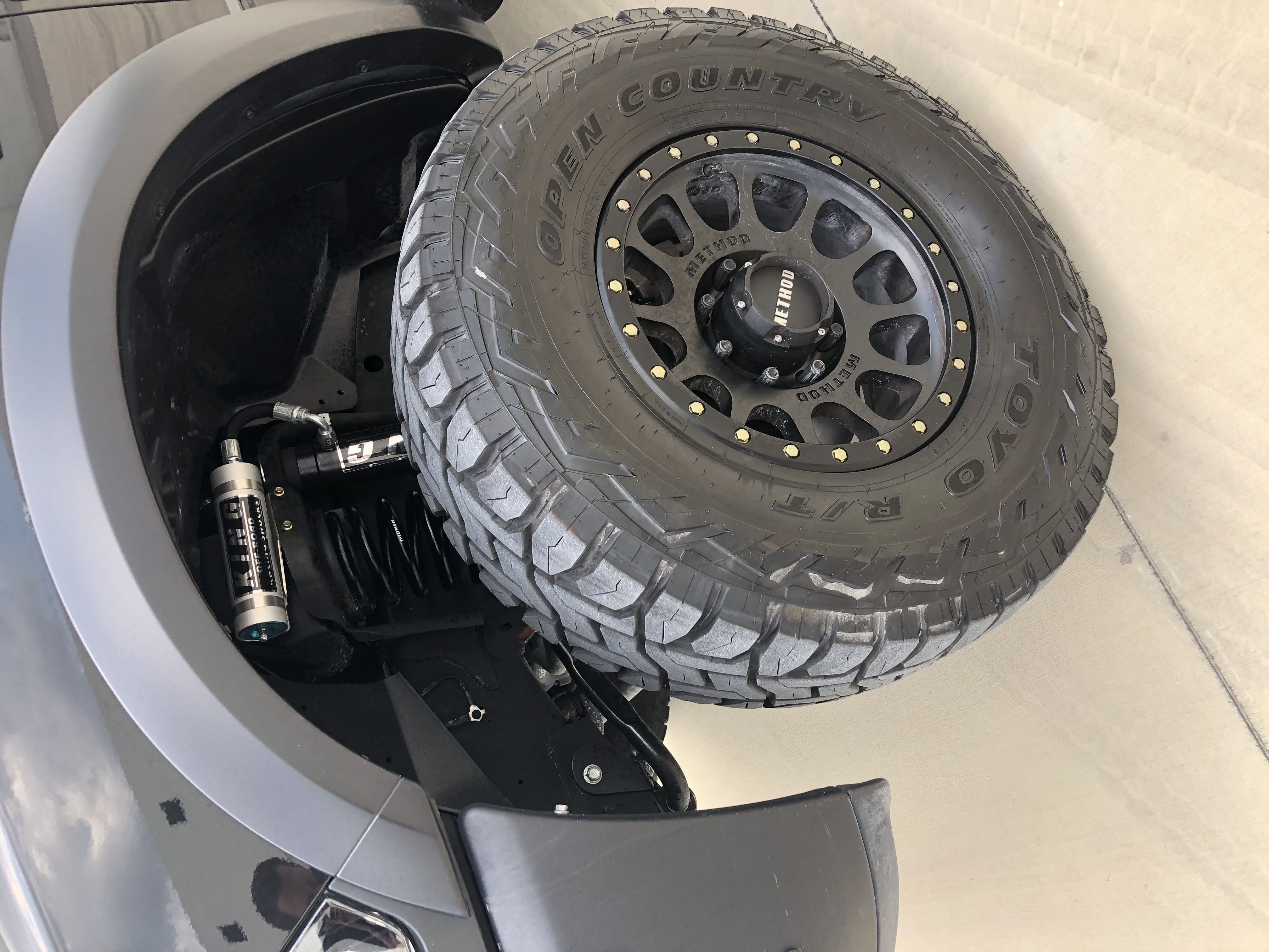

17x8.5 4.75"
TOYO RT 35x12.5/17 Load E
LOAD INFLATION -Tire Limit(PSI)
35X12.50R17LT---1875(25) 2155(30) 2405(35C) 2625(40) 2840(45) 3000(50D) 3065(55) 3130(60) 3195(65E)
Running 45PSI front and 35PSI rear
Rub on the rear lower plastic liner that juts out near the bottom outside corners of the front wheel wells. about 50% to full lock it rubs.
only on slight off camber/uneven turns or with passenger. no wear yet, and i didnt want to chop anything because my lift is only a couple months away. no body modification if possible!
you could not offroad without constant rubbing. at least i wouldnt....i guess the AEV salta may clear 35s on the PW, but i believe you still need a lift to offroad with this setup, or chop the truck.

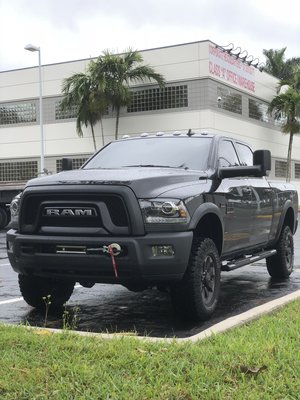

Updated the planned and completed .
Thuren PW bumper is ordered.
i will get a black Warn Fairlead and Yellow Baja pods for the Winglet Fog holes, and two baja spot pods next to winch, powered by a switch.
i would like the yellow fogs on with lowbeams with oem switch and spots activated with highs
