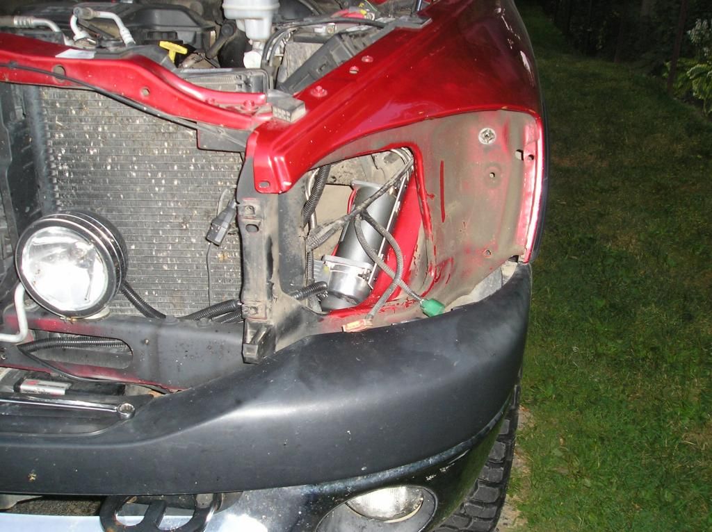

Been working on getting my truck set up for some extended camping. I chose an onboard compressor for airing up my tires . I've had a powertank mounted in my Jeep rubicon and just didnt feel like loosing interior space to it. The Ham radio for communication while on the trail. I've never been a fan of CB's. The ARB fridge makes life so much easier than even the best Ice chest. It's my favorite piece of camping gear so far.

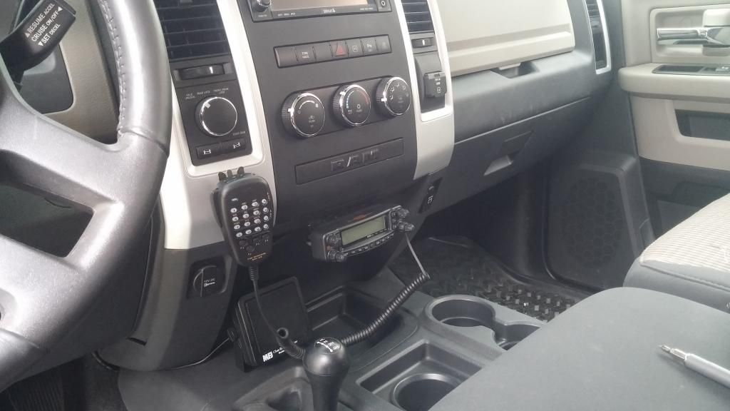

Yaesu FT-8800R mounted under the seat and remote head on the dash

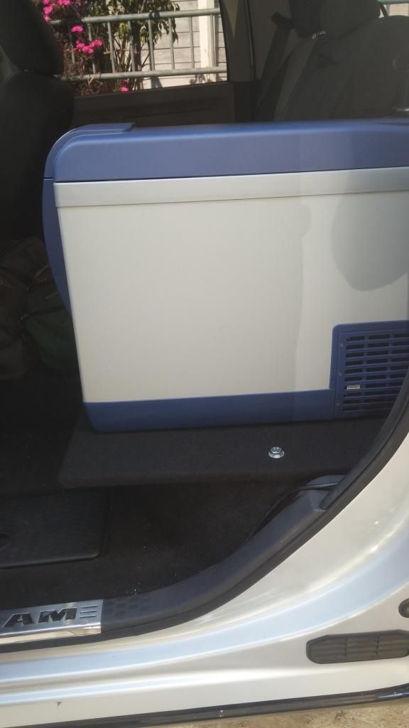

ARB 50 qt install 3/4" plywood bolted to the stock seat mounting holes using longer bolts. The fridge is bolted to the plywood using longer hardware in the standard mounting holes in the fridge. Black paint is next, losing the underseat storage is the downfall on this mod.

Excellent choice in radio.Takingatrip1 wrote:Yaesu FT-8800R mounted under the seat and remote head on the dash
I bought a second sep kit and a universal (AMPS-pattern) suction-cup mount for mine in this truck. I removed the suction-cup part, filled in the hole with epoxy, and VHB-taped the mount to the windshield. Doesn't slide around or fall off with temp changes.... stays where I put it now.
2nd sep kit for the mic. L-com RJ12 panel-mount coupler on the kickplate, small speaker mounted behind the kickplate next to the coupler. (There's an L-com USB coupler in the middle of that kickplate for the stereo.)
Brains are mounted under the back seat, 8AWG from the battery to the amp, then I used the amp's terminal block to connect the radio's power cable.
Antenna's an MFJ glass-mount on the rear window. Not the "best", but it works well enough.
Works awesome, and I avoided having the "trucker-mic" hanging from the rearview. Keeps everything nice and clean.

I like the onboard air compressor. Every now and then I think about adding something like that. I'm just worried the de-icer crap they put on the roads in the winter here in Montana would destroy the air compressor.

Nice work. On-board compressors are the cats behind for airing up on the trail. Not to jack your thread, but for the sake of 04-2500 and maybe others, do you 4th gen guys have empty space behind the headlight like us 3rd gen guys do? My compressor has been mounted there for 4years of Canadian winters and still as good as the day I installed it.

There isn't nearly that much room on my '12. The back of the headlight takes up all yhe space between it and the fender liner, then the battery, TIPM and wiring loom takes up the rest. The passenger fender does have some fender room, but idk if you would have enough for that, I'll have to look again to be sure. There just might be.

The engine compartment would have been my first choice but it's roomy but strangely un usable

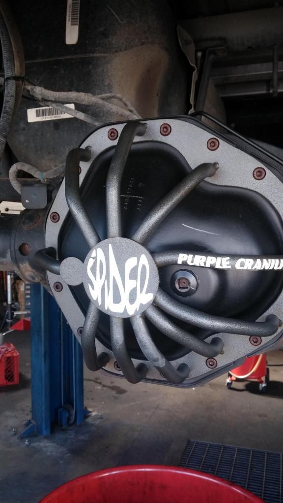

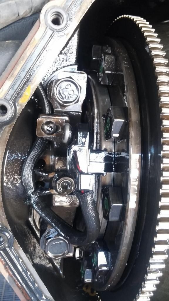

Had the differentials serviced today. Fully intended to do it myself and then....I caved and took it in. At least im clean
and so are the magnets for the lockers now. This is a shot of the build up . The truck has 45K on it, I bought it with 35K on the clock. Looks like the diffs may never had been serviced ?
Considerable amount of filings attached to the magnet ...all gone now

That is clean diff if you ask me. I like your spider diff guard,,,,,but why would they only only put a tiny little weld on each of the little arms?? the first time you take a light strike on that cover those arms are going to pop right off.. Hopefully they are butt welded through the flange. If they aren't,, I would fully recommend pulling off that diff guard and welding a full "round" weld on those arms where they touch the flage, or take it to a welder to make that happen.. Or mail it to me, and I will weld it bulletproof. willing to bet that under the "spider round" sign, there are tiny welds too.
I would not worry about it if your not planning to take it into the rocks,,, but damn,,,, I figured they would have taken the time to make it stronger.

As a welder, I'd have to agree with gunny!! Those are nothing but decoration welds. Maybe it's holed out behind the plate, where the legs meet, and plug welded from behind?

That differential guard and a Carli front came on the truck from the previous owner. I'm not a fan of a "guard" I only buy covers (arb front and back on my Jeep). That being said... According to the manufacturers Web site these guards are back welded. http://purplecranium.com/c-53685-axle-a ... uards.html

carpeted the platform under the fridge today. Came out looking factory, 19 bucks never looked so good

The front Purple Cranium guard on Cactus Red and front and rear PC guards on our JKUR have taken all the abuse with no problems. They have kept the stock covers from peeling back, and been whacked on rocks with no damage.
Nice job on the fridge! They are indispensable once you get one.

I also have PCP front & rear diff guards. The steel rod is solid & yes, they go through the bolt circle & are welded & ground flat on backside.

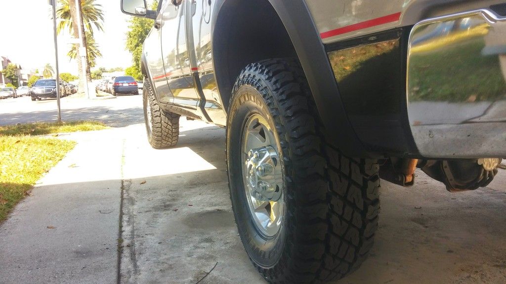

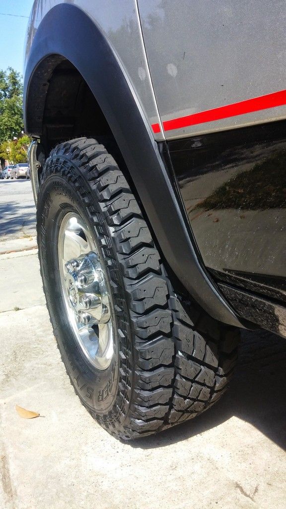

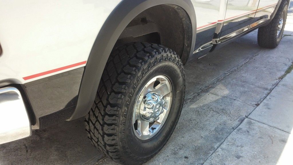

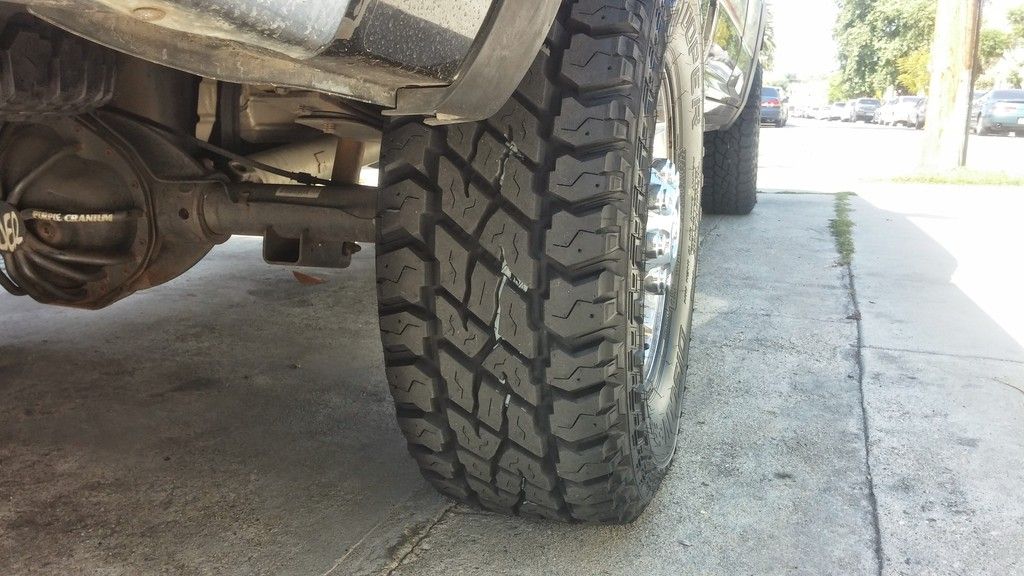

Got my Cooper ST MAX tires mounted today. Stock wheels with Turen Control arms ...no other modifications. Slight rub on the driver side upper control arm at full lock. Spare fits in stock location with the heat shield removed (my exhaust is not stock)

I can hear them faintly on the highway with the radio off. The ride is very smooth, the steering has gotten heavier but the truck feels even more substantial and planted. The additional tire size has changed the final drive ratio. It seems to have smoothed out the acceleration. The truck feels less of a tire smoking hot rod to me now. The rpm's on the highway are down noticeably (exhaust not as loud) . All in all I'm happy with 35's vs going bigger. I'll update after my next Highway /desert trip.
America's Tire was 290. Each plus all the bs...
Each of the 5 tires took about 3ozs each to ballance
