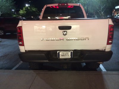

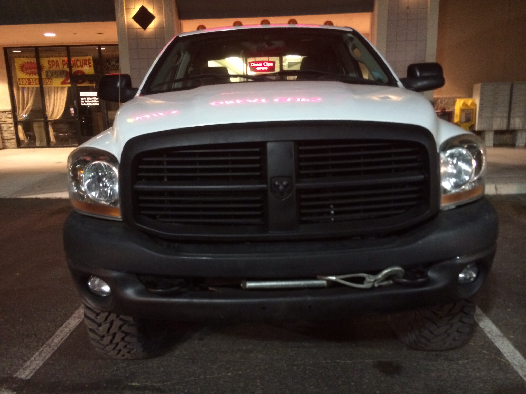

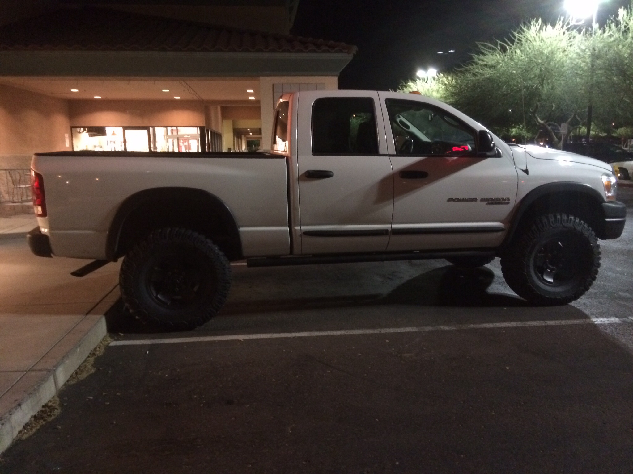

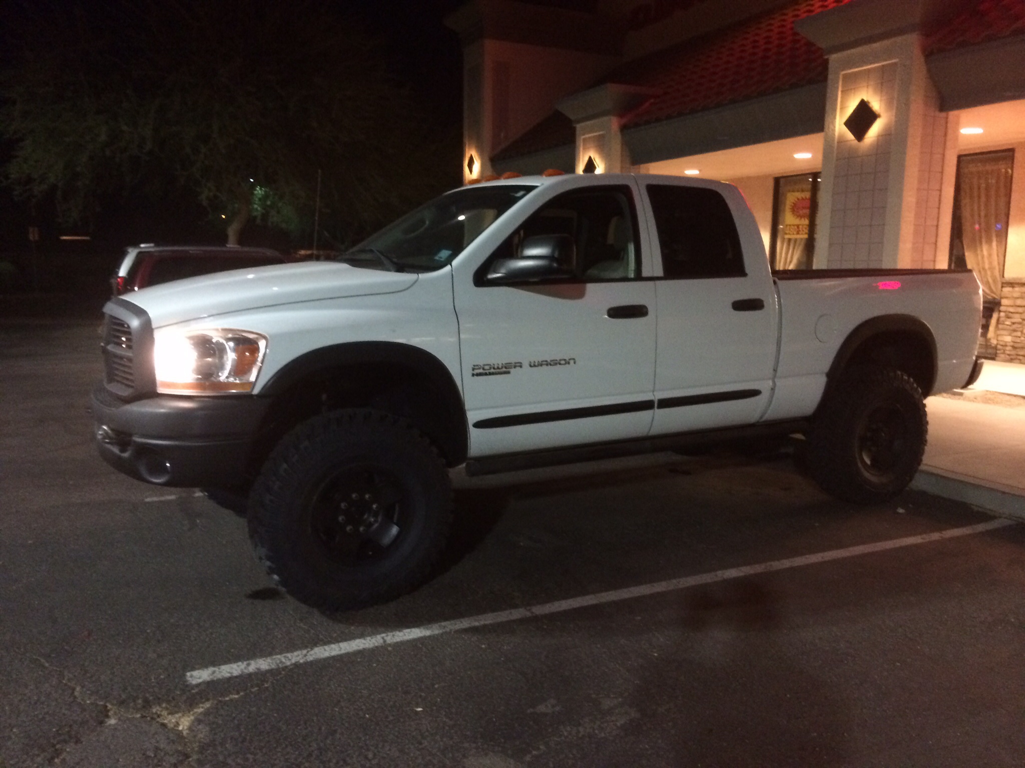

Here are some parking lot pics with the Carli lift installed.  Just picked it up tonight.  The guys at Strapt Performance did a really good job.  Good people to work with.  Now gotta get it out for a shakedown run.

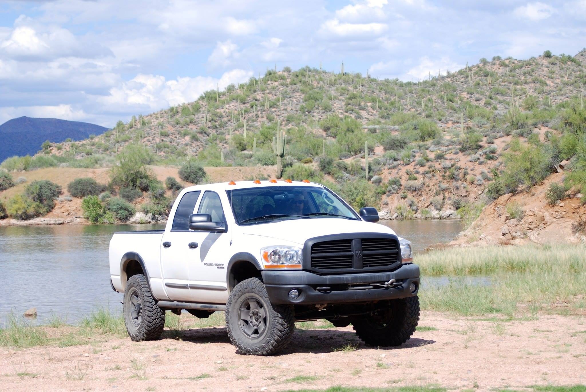

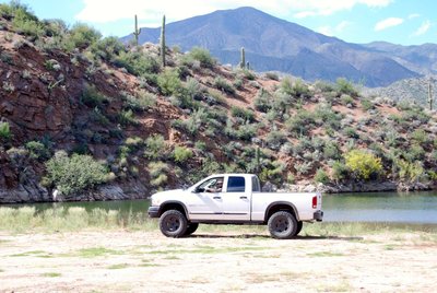

A couple of recent pics of the Power Wagon.  Just a scenic drive up to Apache Lake.  The PW is all ready for my hunting trip to Wyoming next week.  I leave on the 11th and deer opens the 15th.
